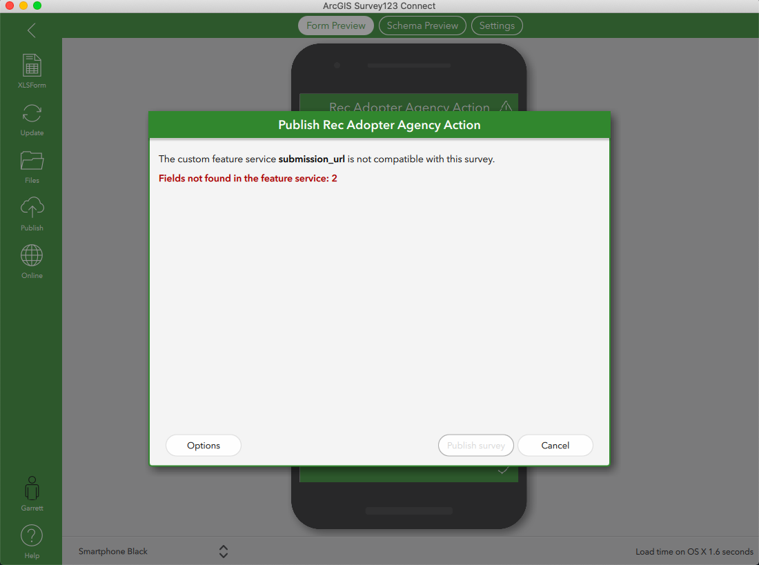

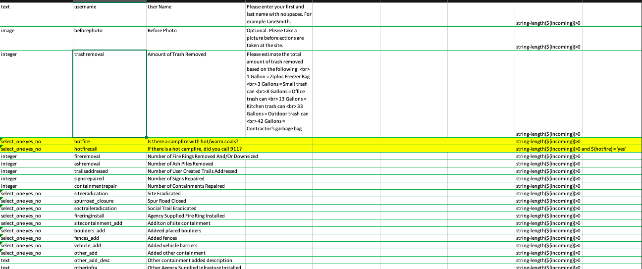

I am trying to add two new questions (fields) to a survey that was published last year that points to a hosted feature layer and three tables (forms). After adding the fields in the XLSForm from Survey123 Connect, I get the following message:
Screen Shot 2023-04-17 at 10.13.07 AM.pngScreen Shot 2023-04-17 at 10.13.07 AM.png
Here are the two fields I am trying to add, highlighted in yellow:
Screen Shot 2023-04-17 at 10.14.00 AM.pngScreen Shot 2023-04-17 at 10.14.00 AM.png
Do I need to add these fields in the form first?

@GarrettRSmith, yes it appears that this is the only way to unlock the schema when there are views that participate in joins (also see the last section of this blog). You could also check in with the ArcGIS Online Community.

Hi @GarrettRSmith,
It isn't possible to automatically add new fields to the feature layer when you're republishing a survey that uses a submission_url.
You can either add the new fields directly to the feature layer via ArcGIS Online and then add the corresponding question to your survey and republish, or if you have access to the original survey that generated the survey, you can add the questions to that survey and the new fields will be added during republish. You would then need to also add the new questions to the survey with the submission URL.
Also, it looks like you are using an older version of Connect - we added some additional republishing functionality in the October 2022 (3.16) release that allows you update domains (used for select_one questions) on republish (for non-submission URL surveys). It also provides more detailed feedback if there are any discrepancies between the questions in your survey and the fields in the feature layer.

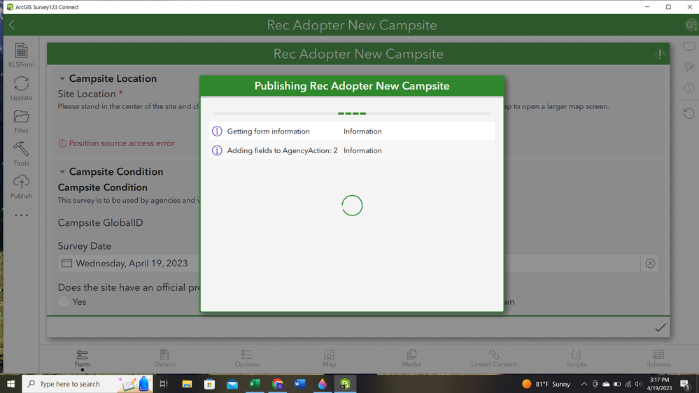

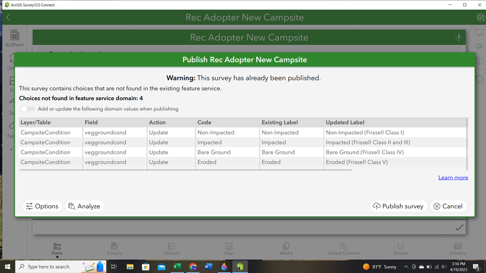

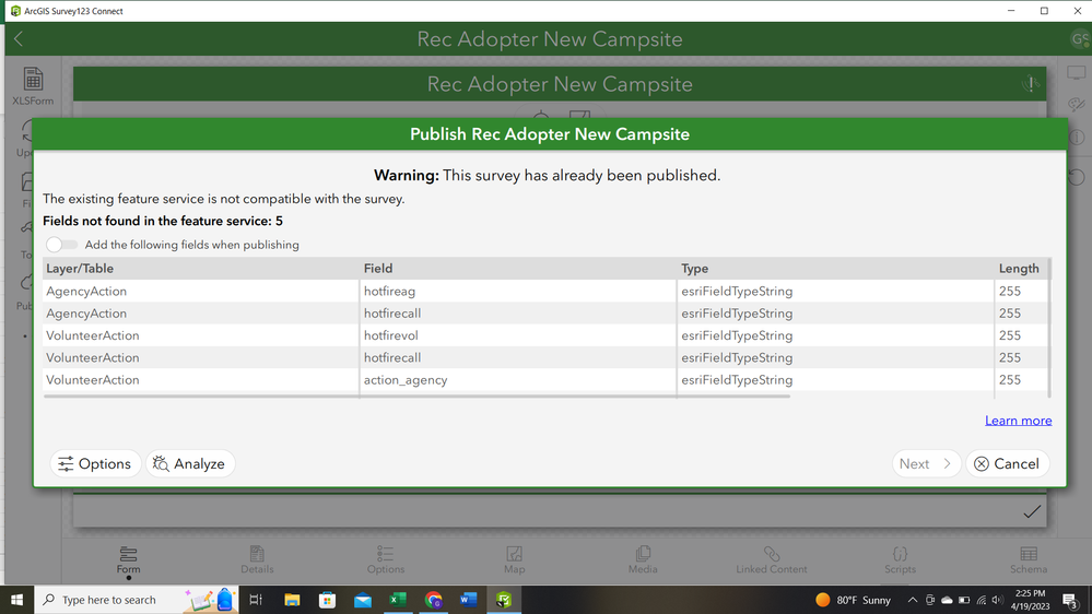

I downloaded Connect onto my wife's Windows computer, created the new fields, and clicked through the options as outlined below, selecting the button that will add the fields and domain values:
However, when I go to publish the survey, it gets stuck on the following screen:
I am going to try updating from someplace else, if this is an internet issue. But, in the meantime, I was wondering if there is something I should be looking at to resolve this issue.
Thanks
BarbaraWebster1
@GarrettRSmith Collecting a diagnostic log may help with identifying the cause of the hang during publishing.

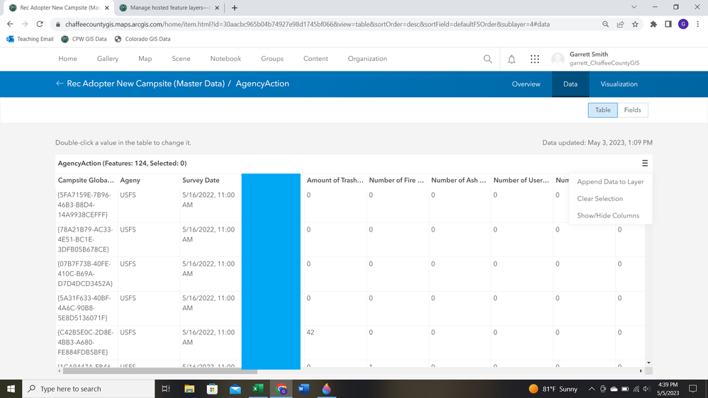

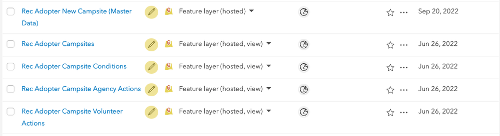

Thank you so much for the link. I think the issue with the schema locking behavior is due to the joins that I have in the data :
Screenshot 2023-05-14 at 5.07.21 PM.pngScreenshot 2023-05-14 at 5.07.21 PM.png
I have joined the feature class (points) with the correct tables:
Screenshot 2023-05-14 at 5.10.04 PM.pngScreenshot 2023-05-14 at 5.10.04 PM.png
Should I delete these feature views to unlock the schema? They are currently being used on a Dashboard but I suppose I can re-create them if needed.
Thanks
BarbaraWebster1
