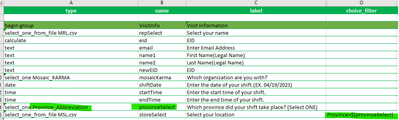

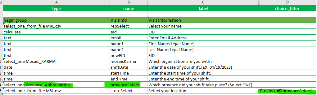

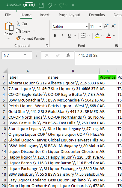

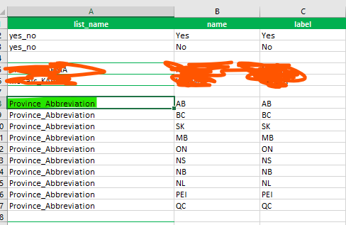

Hello,
I am trying to filter a large external store list by province which is selected in the question above.  I am struggling to get this working.  Nothing appears in the list with the choice_filter on it, but if I remove the choice_filter, all stores appear. Hopefully the screenshots below help - let me know if I need to provide more info to solve.  I am new to this, so hopefully an easy solution I am just not finding!
Survey tab:
Choices tab:
MSL file:
RyanBrown7
I figured it out! I had 2 province columns in the csv.  One was a blank column at the end of the file that I accidentally snuck in.  Thank you!

RyanBrown7
