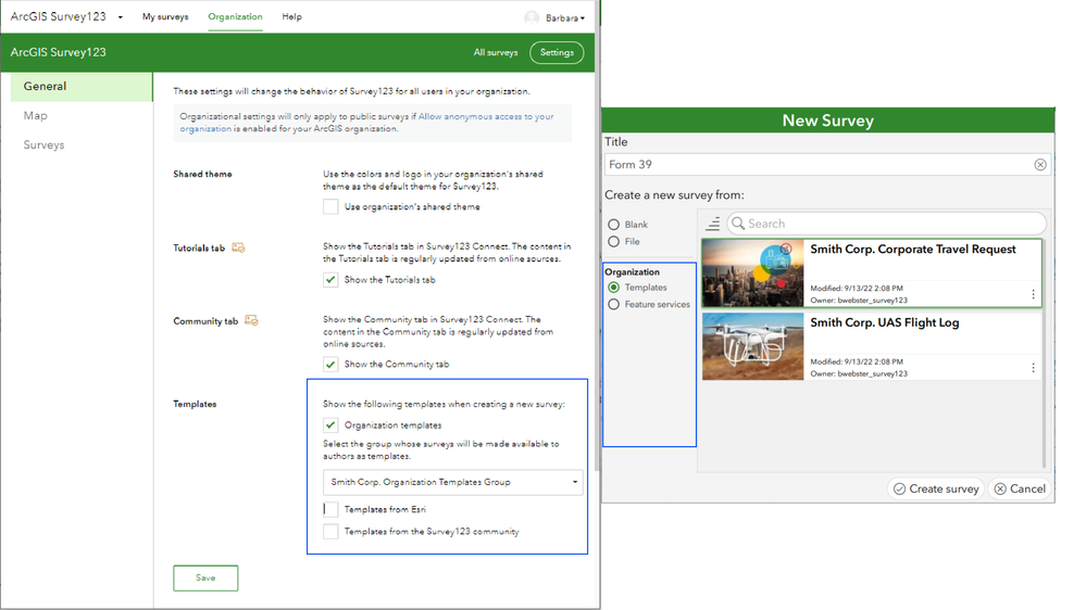

Organization Templates
It is now possible for an organization administrator to share templates that other survey authors in their organization can use. For example, an administrator may want to share a set of templates that use a standard color scheme, branding, layout, or preconfigured choices for questions.
Organization templates are configured in the Organization tab in the Survey123 website by selecting a group containing the surveys to be used as templates.
Organization templates must be a form item. Any form items that have been added to the organization template group will be visible in the Survey123 Connect organization templates gallery as long as the item sharing settings permit the user to see the form. Organization templates created in the Survey123 web designer also will be visible in the organization templates section of the Survey123 website.

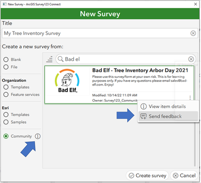

The Community template category is not new, but it is getting some exciting updates. A new community gallery info button provides access to additional information about the community gallery. This links to a community landing page that provides an option for submitting your own survey, as well as featured community templates, and other information related to the community gallery.
Connect also now includes an option to provide feedback or view additional item details for a specific survey. This option is also available in many of the other template categories.

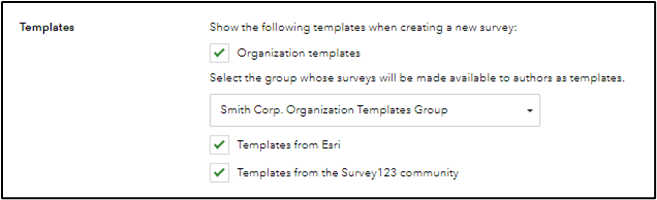

Control which template categories appear in Survey123 Connect
Organization administrators can now configure which template categories appear in the New Survey dialog in Survey123 Connect and web designer. These settings will apply to all users in the organization, and are available on the Survey123 website in the Settings section of the Organization tab.

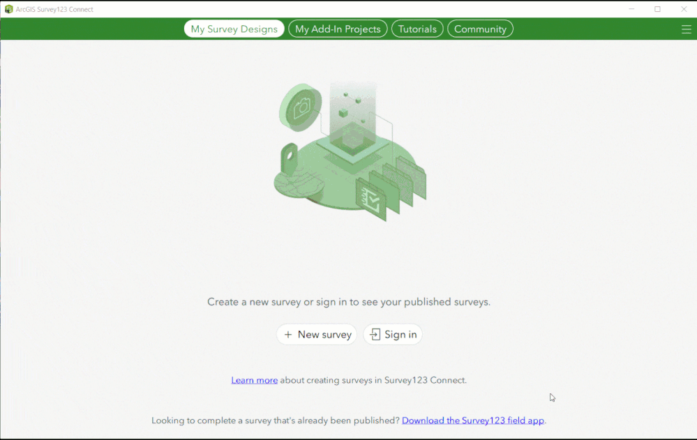

In order to allow these organization settings to be applied more consistently, if the Survey123 Connect user is signed out, the sign in screen will now appear after clicking the New survey button instead of after clicking the Create survey button.

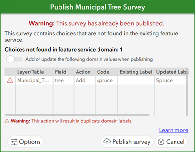

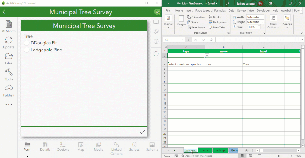

When a survey with a select_one question that uses a choice list from the choices tab is published from Survey123 Connect, a domain list of the choices is automatically created in the survey feature layer. In previous versions of Survey123 Connect if the choice list was updated in the XLSForm and republished, the domain list in the feature layer was not updated. This required survey administrators to make the desired changes both in Survey123 Connect and in the feature layer domain list. This was cumbersome for surveys with large quantities of choice list changes or choice lists that change frequently.
With the 3.16 release, changes made to the choice list in Survey123 Connect can now be applied to the domain list in the feature layer when the survey is republished from Survey123 Connect. If Survey123 Connect detects changes to the choice list when the survey is republished, a dialog will appear that summarizes the changes and provides an option to apply them to the feature layer or ignore them.
Survey123 Connect will only add new domain entries or edit domain labels and will never delete existing domain entries. This is because a published survey may have existing data using that domain coded value.
This table describes the change that will be made to the domain list on republish for a few common types of updates to the XLSForm choice list.

Survey123 Connect will also provide a warning if an addition or change would result in two domain entries with the same label.

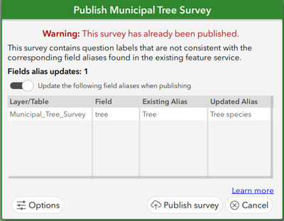

By default the question label that is set in the survey XLSForm will be the alias for that field in the survey feature layer that is generated. There are some situations where the survey author may want to update the question label and field alias. For example, the author may need to correct typographical errors or make minor updates to fields.
There are also situations where the author may want to set the XLSForm question label to be different than the corresponding field alias. This is configured by setting a custom field alias in the bind::esri:fieldAlias column. For example, when a question label is in a question format like, “What is your favorite color,” the author may prefer to set the field alias to something more concise like “favorite_color.” Another example is if HTML tags or references to other questions (using the ${question} syntax) are used, the survey author can prevent them from being included in the field alias by setting a custom field alias.
Previously, Survey123 Connect did not apply updates to the field alias on republish, and the author would need to make changes both in the XLSForm and in the feature layer. In the 3.16 release Survey123 Connect now applies field alias updates on republish. If you change a value in a question label or bind::esi:fieldAlias column in the XLSForm of a survey that has already been published, Survey123 Connect provides the option to make this change to the field alias in the feature layer. This option is displayed in a dialog similar to the one shown for domain changes so the user can see a summary of the changes and decide whether or not to apply the changes to the feature layer.

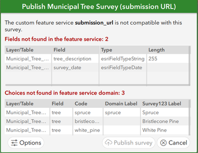

Submission URLs
When publishing or republishing surveys that use a submission URL, Survey123 Connect now provides a summary of any fields or domains that are missing from the feature service. This new feature was created primarily in response to user requests. Many users with larger surveys requested that Survey123 Connect provide more information to assist them in resolving discrepancies between their XLSForm and the feature layer that their submission URL points to.
Just as in previous versions of Survey123 Connect, it is not possible to update the feature layer during publishing when using a submission URL. However, this summary helps the survey authors to know which questions are causing conflicts so they can make the necessary changes to the XLSForm or the feature layer.
Survey123 Connect will not allow the survey to be published if there are fields not found in the feature layer. However, it will allow the survey to be republished if there are discrepancies between the domain and the XLSForm choice list. This is consistent with the behavior in previous versions of Survey123 Connect, but now the survey author is provided with a more detailed summary of discrepancies between the XLSForm and feature layer.
