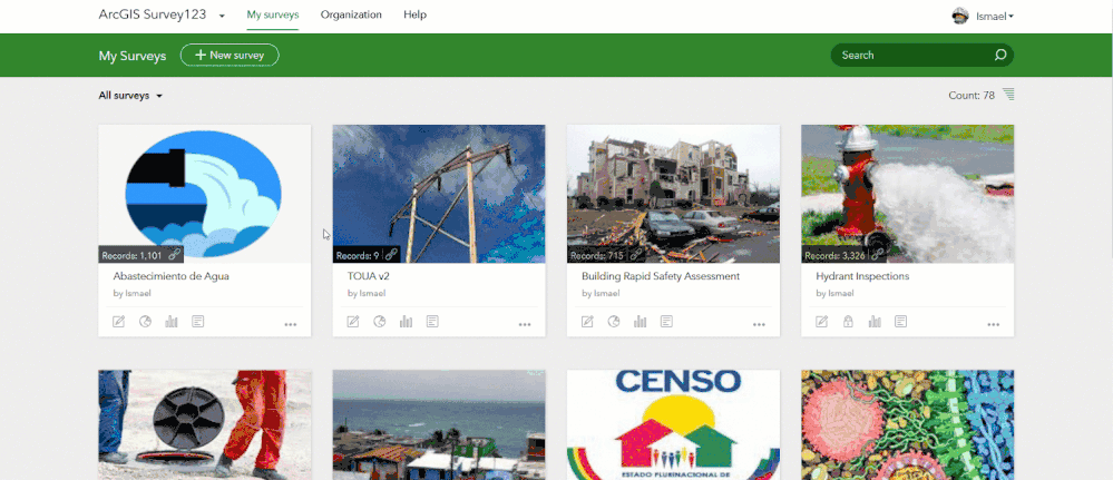

If you are not familiar with the Survey123 designer, you can start using it right away. Once you are signed in to ArcGIS, you are just a few clicks away:

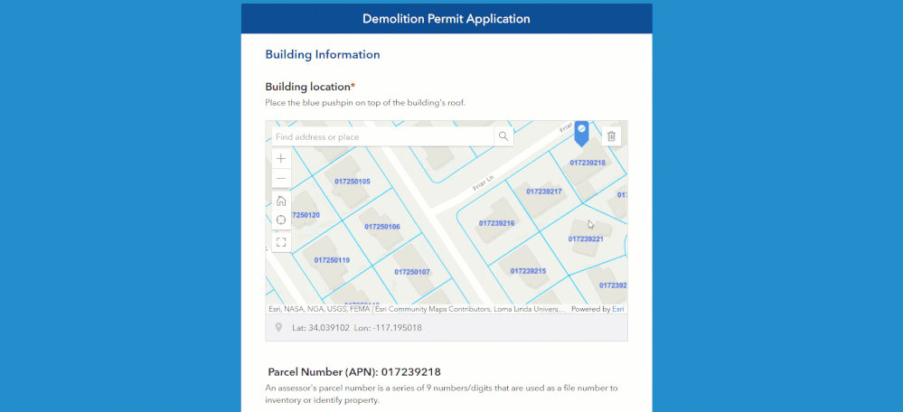

Calculations have been available for a while in the Survey123 web designer. With this release, you can now configure geo-calculations. This will help you make your forms geographically smarter!   Below is an example where a geo-calculation automatically gets the APN (Assessor Parcel Number) of a parcel, when the respondent clicks on it.
To retrieve the APN, the form uses the location from the map to do a point-in-polygon query against the parcels layer.  Parcels are just one example.  You can configure point-in-polygon queries to hit any polygon layer you may already have in ArcGIS. You also decide the value from the intersecting polygon that you want as an output for your calculation.
The video below shows, step by step, how to get started with geo-calculations.

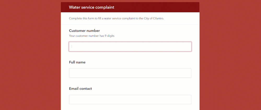

As you play with this new option, you will soon discover that you can do attribute queries in your calculations too. This is useful when you want to simply take a value and do a lookup search on a table or layer to bring some additional data into your form.  Below is an example where I take a customer number and automatically retrieve the full name and email contact of the customer. That's all done through a simple attribute query calculation.
I bet you will figure out how to do that with designer! 🙂

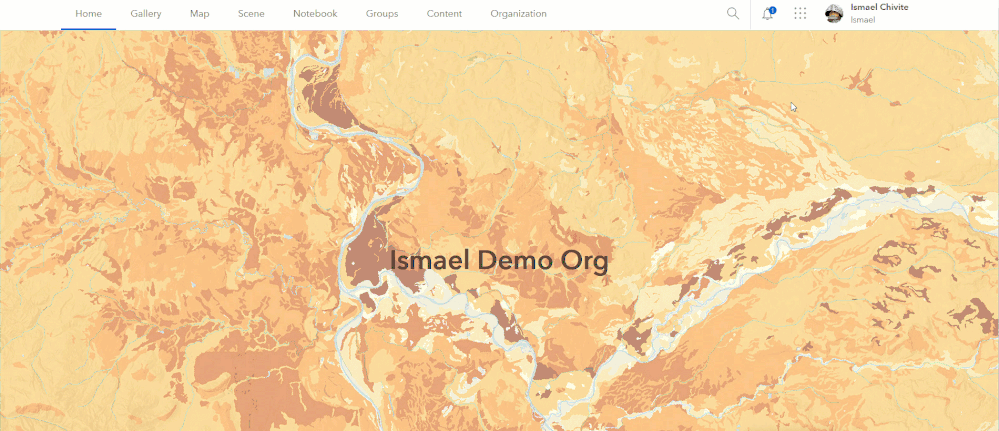

As more and more users in your organization are granted permissions to create new surveys, providing direction and guidelines for survey design becomes more and more important.  Starting with this release, you can configure a set of surveys as templates for Survey123 authors within your organization.
The animation below shows what an organization Survey123 template gallery looks like. Note that when the survey author chooses to start a survey from a template, 6 custom survey templates appear.
Your organization templates can include common survey designs that people will want to reuse again and again. Why should survey authors have to start from scratch?  Survey templates will save time, and also bring consistency.
The following video demonstrates how you can configure Survey123 to present a custom set of templates to all Survey123 authors in your organization.
