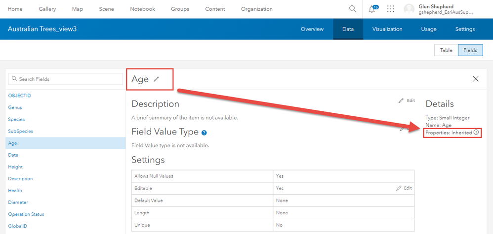

Scenario 2: We've added new domains to the 'List of Values' in a particular field for our parent Feature Layer and cannot see them being inherited by a View Layer
Solution: clicking on the "Reset to source" button to revert the view layer's field update property from "Overridden" to "Inherited".
  • This disconnect may have occurred due to changes being made to specific fields within the View Layer, causing the field properties to change from "Inherited" (from the parent layer) to "Overridden".
  • The simplest way this occurs is if changes are made to field names. This causes a break between the aliases in the parent table and those in the View Layer table.
  • For example:
    By default, changes made to the parent layer are "Inherited" by the view layer. Properties: Inherited
  • However, if a change is made to the field name, the view layer's update property becomes "Overridden" and changes to the parent hosted feature layer are not reflected. Properties: Overridden
  • The connection and inheritance can be re-established by clicking on the "Reset to source" button (pictured above) which will revert any changes made to the field, back to that of the parent Feature Layer. The user should check all other fields to ensure this hasn't happened elsewhere.
