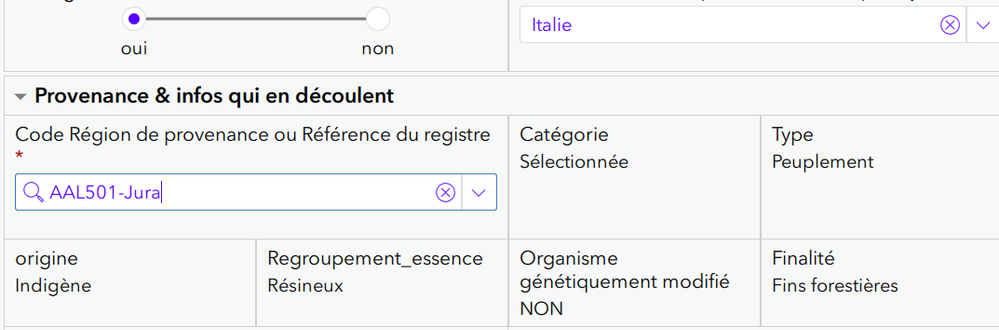

Survey123Connect allows to style entry text/selected values with a color-picker  colorpicker.PNG.
The chosen color is applied to interactive questions only: read-only fields have the default style (thin & black).

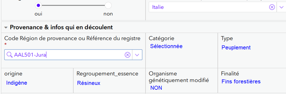

=> Would it be please  possible to apply the selected style to all answers, including read-only answers?

A picture is better than a thousand words, so:
Here is what we have today:
and here is what we would looove to see :
