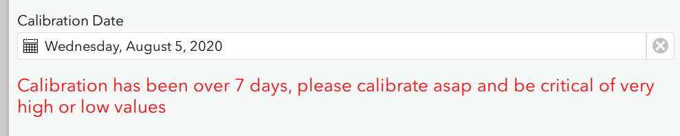

One way was to add inline text warnings using html tags for color.
type  Name                             Label
note CalibrationDateWarning <font color="red" size="4"> Calibration has been over 7 days, please calibrate asap and be critical of very high or low values </font>
With a relevant of
${CalibrationDate}<date(decimal-date-time(now()) -  7)
But this takes up a lot of space which is esp an issue in grids.

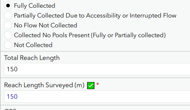

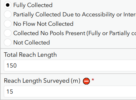

I found a post on using emojis and the ability to now use fields in labels.  These can be combined to provide inline instant checks.
If fully collected then the two numbers should match.
Good
Bad
This small icon is esp useful in grids.

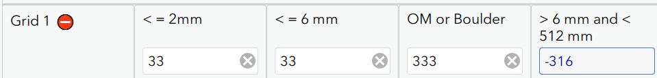

In this case setting up Grid 1 takes a hour.  The crew would not get an error at all until the end of the form, which meant having to go back and re-setup the grids.  Now they know right away if anything was wrong (usually a typo).
Here is how you do it.
For example 1 above
Add a calculate field that holds the check.  An if statement will determine if the value is good or not and returns either the good emoji or bad.  Note you can set esri bind type to null so that this is not in the schema.
type         Name                               Label                              Calc
calculate ReachLengthCheck          ReachLengthCheck       if(${PoolsCollected} = "Fully Collected" and ${PoolReachLength}=${TotalReachLength}, "&#9989;", "&#9940;")
Then use this field in the label of the question.
type            Name                         Label
decimal      PoolReachLength       Reach Length Surveyed (m) ${ReachLengthCheck}
In the grid example above I got a little more fancy.  I do not want the emojis to show at all until they actually fill out all of the data.

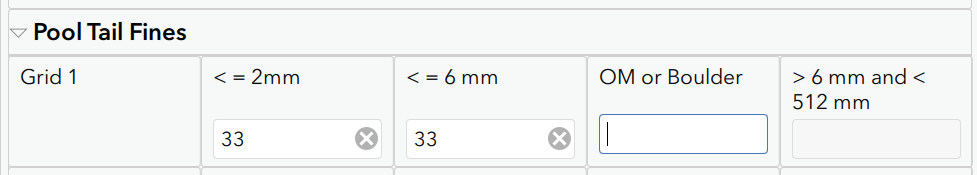

Partial fill does not have emoji

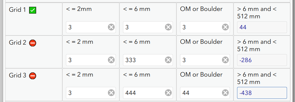

Once all 3 are in then you get the emoji
To do this simply wrap the check in another if to check for empty cells and return blank "".  In this case I can just check true/false on the last column since it will be "" until all values are in.
if(${PoolTailFinesGrid16to512mm},if(${PoolTailFinesGrid1LessThan6mm} < ${PoolTailFinesGrid1LessThan2mm} or ${PoolTailFinesGrid16to512mm} < 0, "&#9940;", "&#9989;"),"")
And again just add this field to the label.
Grid 1 ${Grid1Check}

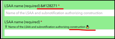

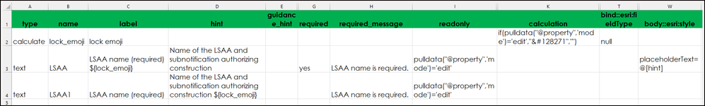

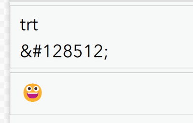

Don't know if this is a bug or I'm missing something, but it looks like there may be an issue inserting emojis in the label of a required question (${LSAA}) where the emoji is replaced with its hex/decimal value. The emoji shows up as it should when the question is not required.
The alternative was to put the emoji in the question's (${LSAA1}) hint, but then it converted the hint to a guidance hint. Remove the emoji and the hint appears as it should.
EDIT to my previous comment about the emoji not showing up on a required question. I neglected to type ";" at the end of the hex charset for the emoji. I typed "&#128271" when it should've been "&#128271;". Now the emoji displays correctly. However, if the emoji is used in a hint, it still converts the hint to a guidance hint.

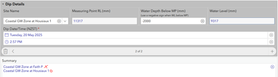

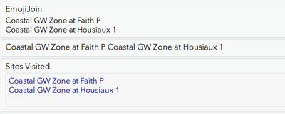

Hi @DougBrowning, have you tried adding emoji's to a repeat summary using join? From what I've tried I can't seem to get it to work outside of a label. e.g. for each site name in the summary, add an appropriate emoji like the red X and O in the snip. Maybe it's just not possible?
DougBrowning
MVP Esteemed Contributor
I think html tags only work in labels.  Not 100% but I just tested and it seems like it.
But one idea is have a hidden field with a calc that has your join and emoji in it.  Then set that field as a label of a note field.  I just tested and it worked.  HTML seems to work in hints also.
Let us know if you get it to go.
JonMarks
Thanks @DougBrowning I gave it a go, but it seems the label doesn't have the same characteristics as a regular field in terms of layout.
The Summary and EmojiJoin fields should give a similar result but they seem to ignore the line feed.
I did get the emoji appearing but only the most recent repeat shows in the label using:
Never mind, was worth a crack just to make my form a little more fancy.

@JonMarks yes \n will not work but I tested and the HTML <br> does seem to work.
I also saw in you post you have pulldata in an if statement.  It will often not update if you do that.  Gets posted a lot so keep an eye on that.
