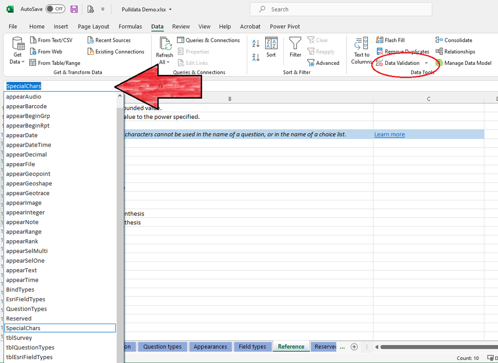

There is definitely more to this and I'm seeking the same answer. The Excel files have increasingly become more and more detailed with additional version releases. Copy and pasting the the headers will work, though your drop-down references will need to be updated as well (see pic).Untitled.png
