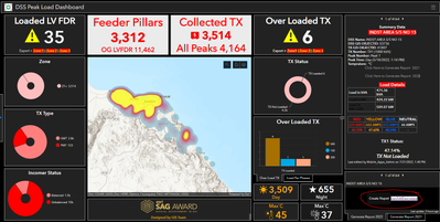

MajidAlabrawi1
Hi  RubenBenne
actually  i embed a report generator tool using (js and html) so now the end user can generate a report within a dashboard.
you can see downright the report there is a button of creating report.

majidalabrawi
Hi @LouisDECOMBE ,
yes i did some modifications. and it works in portal enterprise , but you need to update the token every 2 weeks , i will share the modified code. and just replace where you need to change the ID's and portal url
copy the below and paste it in xhr js file
