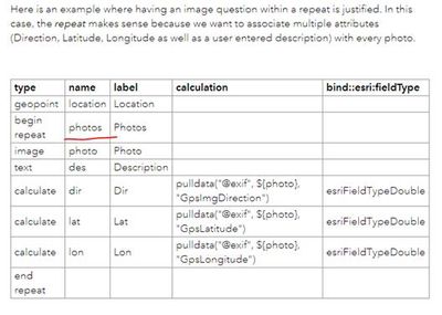

Here is an example where having an image question within a repeat is justified. In this case, the repeat makes sense because we want to associate multiple attributes (Direction, Latitude, Longitude as well as a user entered description) with every photo.
typenamelabelcalculationbind::esri:fieldType
geopointlocationLocation
begin repeatphotosPhotos
textdesDescription
calculatedirDirpulldata("@exif", ${photo}, "GpsImgDirection")esriFieldTypeDouble
calculatelatLatpulldata("@exif", ${photo}, "GpsLatitude")esriFieldTypeDouble
calculatelonLonpulldata("@exif", ${photo}, "GpsLongitude")esriFieldTypeDouble
end repeat
Note that photos in the repeat table have attributes to extract their direction, latitude, longitude and even a user-entered description of the photo. Storing all these attributes for every one of the photos would not be possible using the multiline appearance in the image question. This is what justifies the use of the repeat.

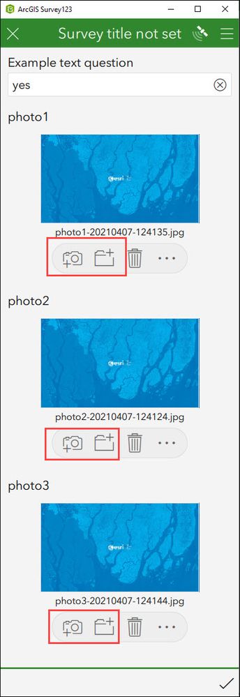

Since the multiline appearance was not available in the past, some of you created surveys with multiple image questions as follows:
typenamelabelhint
imagephoto1Photo
imagephoto2PhotoDon't do this. Use mutliline appearance in photo1 instead
imagephoto3PhotoDon't do this. Use mutliline appearance in photo1 instead
Now that the multiline appearance has been added, it is time to adjust the XLSForm design accordingly. Remember you can also use the count-selected() function to limit the number of photos that you want people to submit. Removing the extra image questions in your form will not cause data loss, however, keep in mind that the multiline appearance is only supported in Survey123 3.10 or newer, so you will want end users to be up to date with their app version or otherwise the appearance will be ignored.

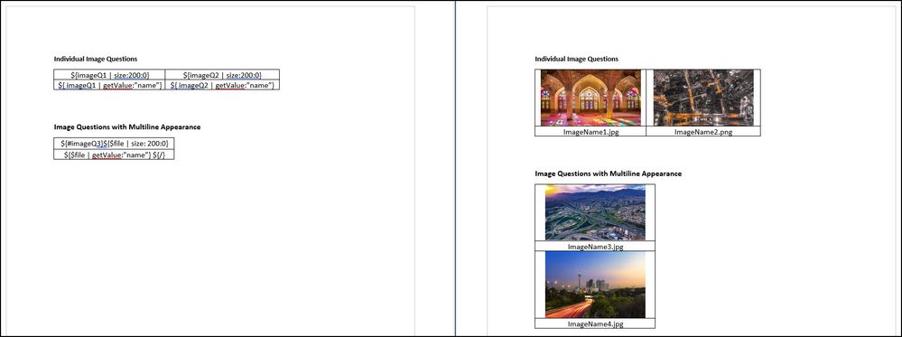

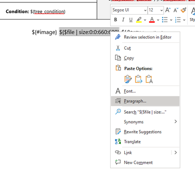

MikeOnzay
Thanks, Ismael. I found that if I put a space or two before ${/} it separates the photos with spaces. It looks cleaner than having the photos jammed up against each other. Is it possible to put each photo in its own table cell? This is as close as I could get.
multiline photos in a table syntax
multiline photos in a table 1 output

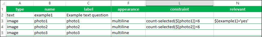

Using count-selected(), you can also also control how many photos can be submitted with a question. For example, you can setup a constraint to limit photos submitted with your image question to less than 5:
I wanted to understand if the constraint is checked at the point that the survey record is submitted rather when photos are being taken/added?
Just that I have set up a constraint to limit the number of photos to 3 but the interface (at least within Connect) will allow me to go through the process of adding a 4th and 5th photo (presumably I could keep on going) and it is only when I come to submit that it says the answer is invalid.
I can put a note above the question to say don't add more than the given number but ideally it would prevent the user from adding more than the constraint.
IsmaelChivite
Esri Notable Contributor
Hi Gareth Baker‌  Constraints are guaranteed to be checked before you send the survey. If you would like immediate feedback, your idea about showing a note is great. Using the relevant column, you can keep the note hidden until the user has uploaded the maximum number of photos. You can also format the note in red to make it more prominent.

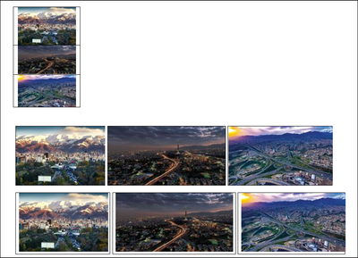

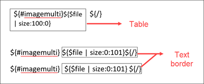

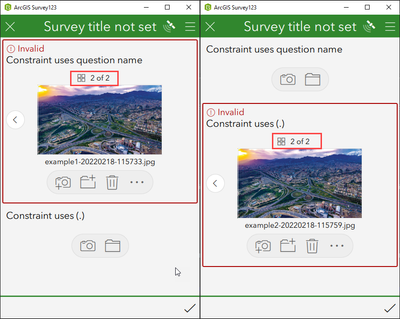

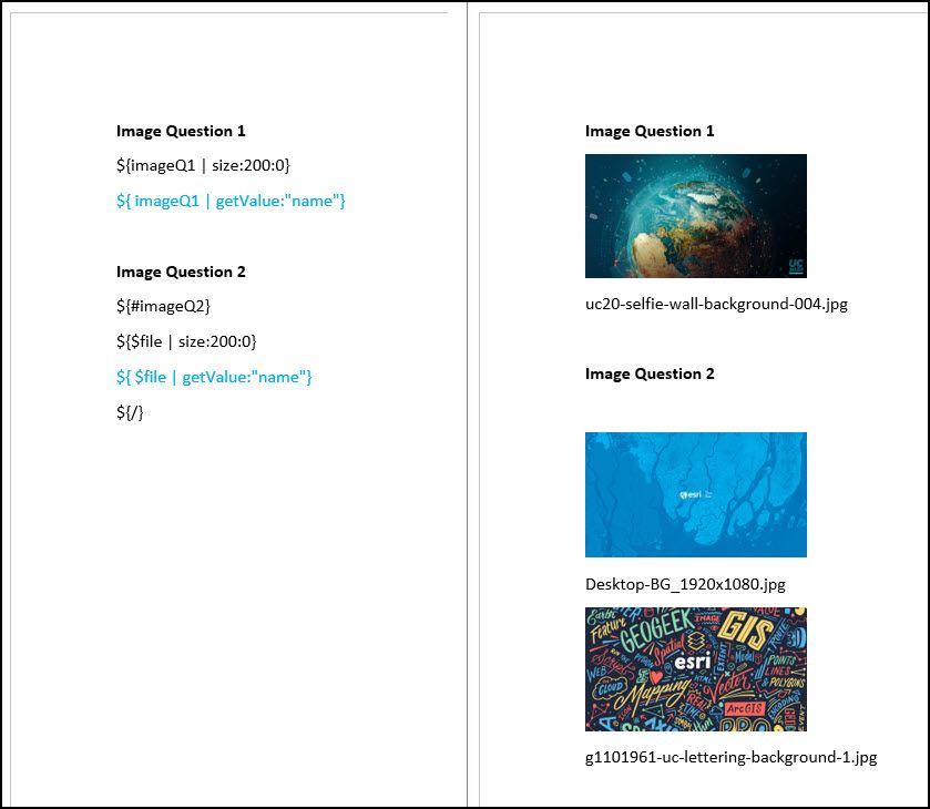

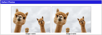

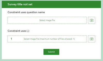

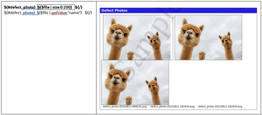

Hi @MikeOnzay
I know it's been a while since you posted on this blog but I've done some tests with a sample survey to find a way to put each image in a separate cell while placing them horizontally. After attempting different formatting options, I couldn't find a way to use tables with a horizontal placement. As you can see in the screenshot below, you can use a table and put each image in its own cell but the only possible layout will bi vertical arrangement.
However, using a border instead of a table, you can get images separately in a border in a horizontal placement. Although it's not technically a table and may not look exactly the same as what you were looking for, but might be a little bit closer.
All the best,
MJ

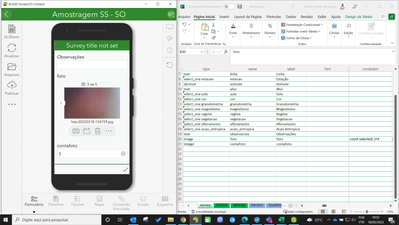

@IsmaelChivite your guide  for creating a count of attached photos works great when submitting a new record (snippet below) but when the user edits the survey (from the inbox) the attachments aren't editable (which I know is a known issue, that you all are working on) but the problem is that the record count also gets reset to null (or zero).
integerphoto_countPhotos submitted count-selected(${photo})
This is a similar problem to other "in form only" workarounds we use (e.g. calculating on non-relevant field) that work on first submission but then do unexpected things when editing a previously submitted record.

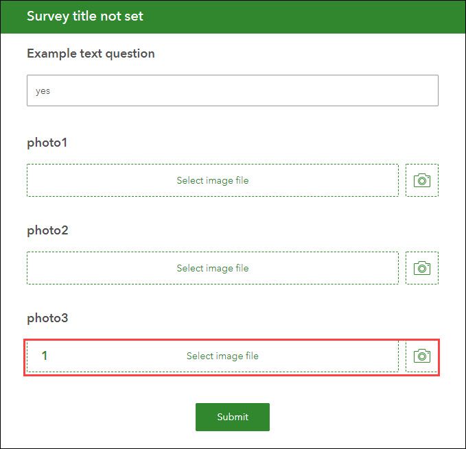

I'm wondering if there is some check in Survey123 that we can use to auto-detect whether the record is new vs in "edit mode"? We can then check for the mode to modify you phot count example to something like "if([new mode],true),count-selected(${photo})". This mode check would also help with other calculations and relevant conditions that give different results when editing.
screenshot of new record before submission
screenshot of editing record from inbox

Hi @MJBiazar,
Thanks for your suggestion. I tried it and it doesn't look that bad.
Mike

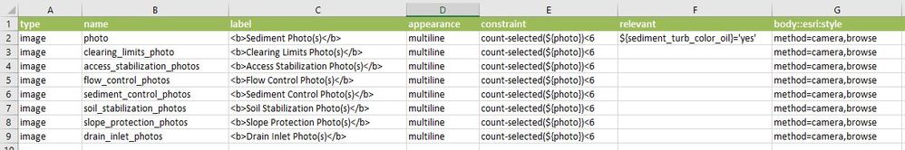

VaLoyBriscoe
I have 8 image questions in my survey. Each question is limited to 5 photos. The first image question is working, allowing more than one photo. The other 7 image questions are set up the same in my XLSform but are only allowing one photo when using the field app. Below are the only fields with text.
MJBiazar
@VaLoyBriscoe
As I can see in your screenshot, all your questions should allow more than 1one photo as they are using "multiline" appearance. However, the constraint for all questions seem to use the number of photos submitted to the first image question ("${photo}"). This shouldn't affect your ability to add more than one image to other questions though.
I've tried to replicate your survey on my end and I cannot reproduce the issue you are experiencing. In field app, all my image questions allow adding more than one image.
However, in web app, I noticed that the image questions with constraint only accept one image. As you can see in the image below, only "photo3" question that does not have constraint allows multiple images.
A defect has been logged against this behavior in web app which is currently under review.
Best,
MJ
VaLoyBriscoe
@MJBiazar Thank you for your response. I figured out that it is a Survey123 Connect version problem. I remote login for work, that computer is using 3.12.230. This is the version I was having problems with.
My computer at home is using 3.9.120. This version's XLSform was missing the "multiline" in the appearance column. When I added it the multiple photos in the field app worked for all the appropriate questions. This version was used to create the original survey.
Hope this helps and thanks again,
VaLoy

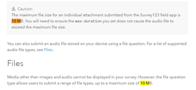

I am looking for clarification on the 10MB file information provided:
When its states that the "maximum files size for an individual attachment" is 10MB, is one attachment 1 question, or is it that all photos from multiple questions are being submitted as 1 attachment? So in total the photos need to be less than 10MB combined?
Thank you for clarifying. I want to make sure the survey I am setting up for a department doesn't run into any photo glitches.
Appreciated,
Jessica Thompson
MJBiazar
Hi @VaLoyBriscoe
Thanks for sharing your findings. Yes, the multiline appearance for image questions was introduced in 3.10 version.
I'm glad to hear that you were able to get the issue sorted out.
Best,
MJ
MJBiazar
Hi @JessicaJThompson ,
That's correct! The 10 mb limitation applies to each attachment. For instance, if you have an image question with multiline appearance, you can upload two (or more) images that each has 9 mb size (total of 18 mb).
So as long as each individual attachment is smaller than 10 mb, you should not hit this limitation.

FedericoRiet_Sapriza
Hi
I'm using Survey123 Connect to design my survey, and then using S123 web app to collect the data.
I would like to have one image question to collect max 5 photos, I'm using multiline but I cannot limit the number of photos, if a use constraint it won't work in S123 web app as mentioned by @MJBiazar in this blog.
I haven't find a solution this issue.
Thanks
Cheers,
Federico

Andrew-Bowne
When adding multiple photos using the multiline appearance type, does anyone know of a way that you can label each photo in a report with it's position in the repeat?  For instance, a user may make a comment in the survey that says, "See photo 1" or "photo 2 shows.....".  I'd like to be able to label each photo with their position so when a user looks at the report they will see "photo 1" labeled under the photo.
Thanks~
pat_algura
Thanks @MJBiazar for that tip!
Do you have any recommendations on how to display the image name right below the image like this sample?
Appreciate the help!
MJBiazar
Hi @pat_algura ,
In order to add image names, you can use the following in your feature report template to get the image/file name:
${imageQuestionName | getValue:"name"}
If you have an image question with multiline appearance (to capture multiple images) you need to use a tag and ${ $file | getValue:"name"} to get the image name:
${#imageQuestionName }
${$file | size:200:0}
For more details about custom report templates, you may refer to the links below:
Understanding Survey123 Feature Reports
ArcGIS Survey123 - Report templates
All the best,
MJ
pat_algura
@MJBiazar I see that this is doable if images were placed vertically, but I can't achieve the same when they are setup horizontally. I'm definitely missing something... any recommendations?
Thank you! 🙂
MJBiazar
@pat_algura I understand what you are trying to do now. I've done some testing and but unfortunately, I couldn't find a way to achieve exactly what you need. The closest option that I found is using a table. However, it only works for individual image questions. It still puts images from an image question with multiple appearance in a vertical layout.

DerrickWestoby
An observation & a question:
Observation - The Paragraph->Line and Page Breaks->"Widow/Orphan control" setting was causing problems for me when it was toggled on.  My photos were restricted to a max height that should allow 2x rows of photos and the preceding tables to display on a single page, no matter if they were portrait or landscape.  I kept getting the table on one page and my photo(s) on the next page though....even if they were able to fit.  Unchecking this option fixed that issue for me.
And a question for @IsmaelChivite or @JamesTedrick -  Is it possible to use a combination of ${image | getValue:"width"} and orderBy with this?  I'd like to print out my photos with portrait orientation first and landscape orientation second and figured I'd accomplish this by printing them out in order of pixel width. (All photos are taken in-app, not attached, so I'm not too worried about mixed image dimensions being attached).
I'm  trying to do something along these lines, but haven't been able to get it working yet:
${#image| orderByFields:"image | getValue:"width" ASC" }
${$file | size:0:0:660:600}

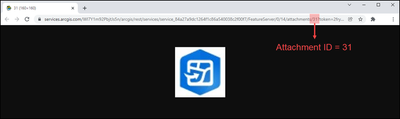

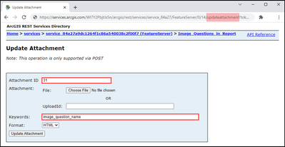

MJBiazar
Hi @HayleighFisher,
You can add attachments through different methods including a WAB application, however, only attachments that are submitted through Survey123 app will have attachment keywords that is what Survey123 uses to associate an attachment with a question in your survey.
The attachments with no keyword (like the ones submitted via a WAB application), won't show up on the survey form when you are trying to edit an existing survey record in Survey123 app (via Inbox or in edit mode in web app).
You can update existing attachments from the REST to add keywords to the attachments that are not submitted through Survey123 app.
  1. Open the Data tab in Survey123 website.
  2. Click on the record with the image attachment missing the keyword
  3. Right-click on the attached image and open in new tab
  4. Note the attachment id in the URL (in this example, it’s 31): https://services.arcgis.com/Wl7Y2PbjtJs5n/arcgis/rest/services/service_84a27/FeatureServer/0/14/atta...31?token=2fr...
  5. Replace the “attachments/<attachment_id>” with “updateattachment” in the URL. Your URL should look like this https://services.arcgis.com/Wl7Y2PbjtJs5n/arcgis/rest/services/service_84a27/FeatureServer/0/14/updateattachment?token=2fr...
  6. Fill out the form:
  • The Attachment ID is listed in the URL after /attachments (from Step 4).
  • The Keyword is the name of the image question that you want to associate this image with.
  1. Click Update Attachment.
  2. Notice that this image now shows up under the image question in form view and will be printed in the report.
Best,
MJ

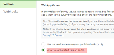

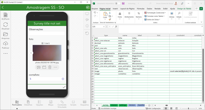

Hey @IsmaelChivite ,
I Have a Doubt about photo limitations.
I tried the constraint formula that you have posted here.
But it's not working properly. I have limited to less than 3 photos, but survey 123 allows more than that as image bellow:
Do you have some adivice about some workaround??
thanks
MJBiazar
Hi @bgomes,
I've ran into a similar issue and I believe it happens only when you reference the image question name in the constraint. Please change your constraint from "count-selected(${photo})<4" to "count-selected(.)<4" and see if it resolves the issue.
Best,
MJ
bgomes
Hey @MJBiazar
Thanks for your quick response.
I did the modifications, but still the same issue.
MJBiazar
Hi @bgomes
Can you confirm what version of Survey123 Connect you are using? I cannot reproduce the issue on 3.13.251. If you have published your survey from an older version, make sure to turn off the version lock to force using the 3.13 web app. Images below show my XLS form and the same survey in web form.
Please let me know if you still experience the same issue.
Thanks,
MJ
bgomes
Hi @MJBiazar
Thanks for your response.
I'm using the 3.13.251 version of survey 123image.
Survey connect not limmit the number of photos.
after publish the form the result was:
1 - Survey web the result is the same as yours.
2 - Field app (version 3.13.246), still not limmiting the number of photos.
The resource of limmiting photos is just for web form?
Thanks
Bruno Gomes
MJBiazar
@bgomes Both constraints should work in Survey123 field app (and Connect) as well. The only difference is that while web app validates the responses against the constraints as soon as input (in this case images) are provided, the field app only imposes the constraints upon submitting the form. Therefore, field app allows adding more images than what is specified in the constraint since the image question has multiline appearance, however, it does not allow user to submit the form.
bgomes
Hi @MJBiazar,
You are completly right!
I was trying to limmit directly in Connect without send. My mistake.
thank you so much!
