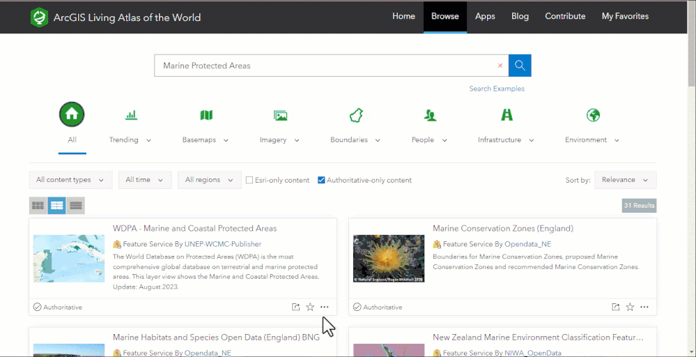

To browse ArcGIS Living Atlas of the World content go to livingatlas.arcgis.com  You can start searching right away!
There are thousands of layers available, many of them from authoritative sources, others from users like you who contribute to the Living Atlas.
Explore the content available. You will find administrative boundaries, environmental, infrastructure and socio-economic data. There are layers with live content such as weather event, traffic and much more.

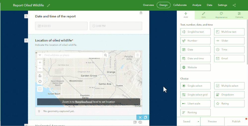

Once you are happy with your web map, you can configure your own Survey123 forms to use it.  The animation below shows how you can configure a Survey123 map to show your own web maps.

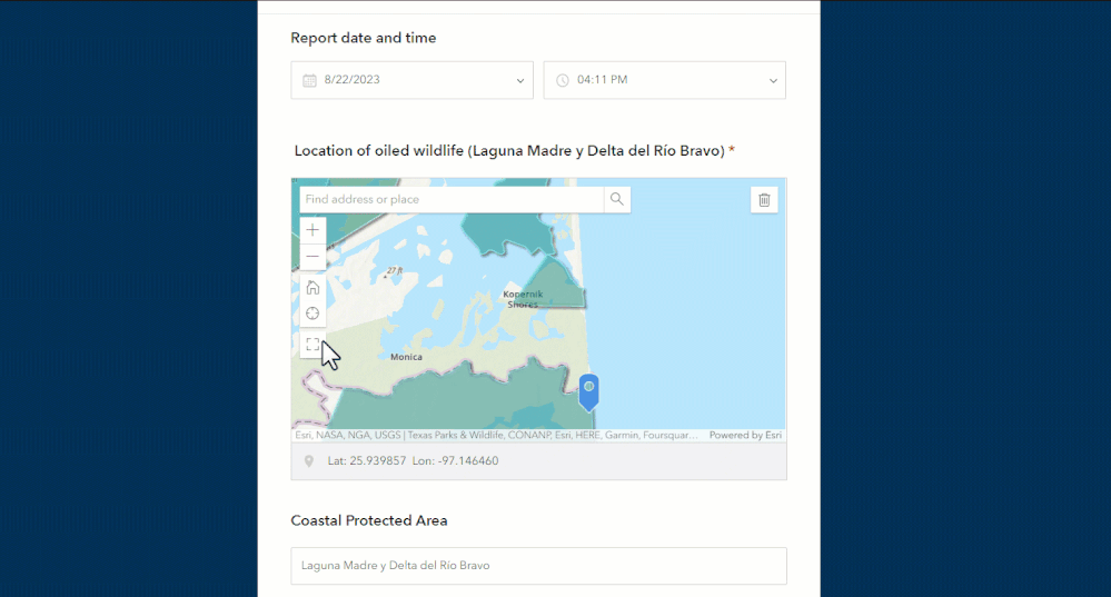

The World Database on Protected Areas (WDPA) is the most comprehensive global database on terrestrial and marine protected areas. In the example below, I take the location of a report and calculate the name of the WDPA Coastal Protected Area where if falls into.

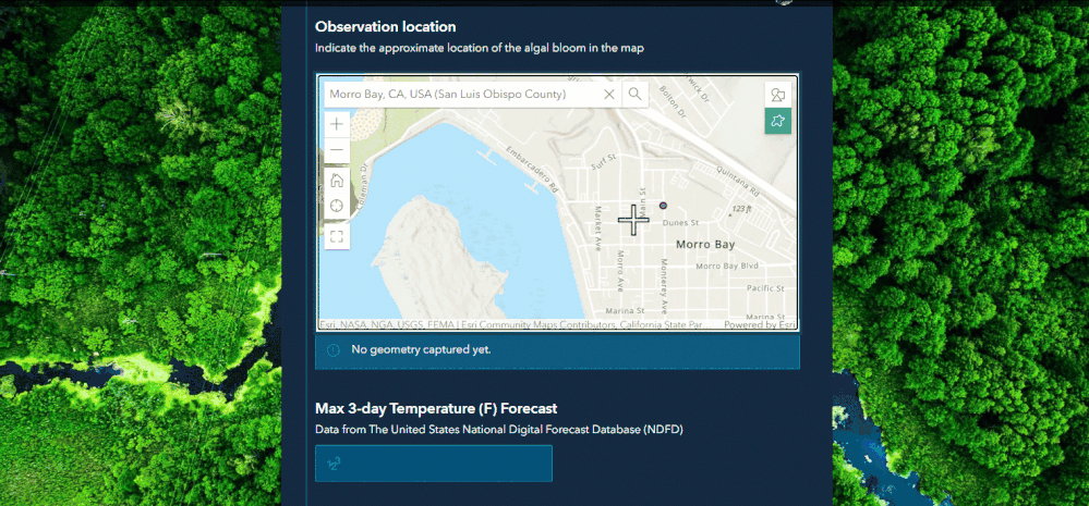

One more! Predictive weather data from the National Digital Forecast Database (NDFD) is used to associate the maximum temperature forecasted for the next 3 days with the algae bloom sighting reported by the user.
Configuring this type of geo-calculations is straight forward using the Survey123 web designer. Check the video tutorial posted in our October 2022 release announcement for details.

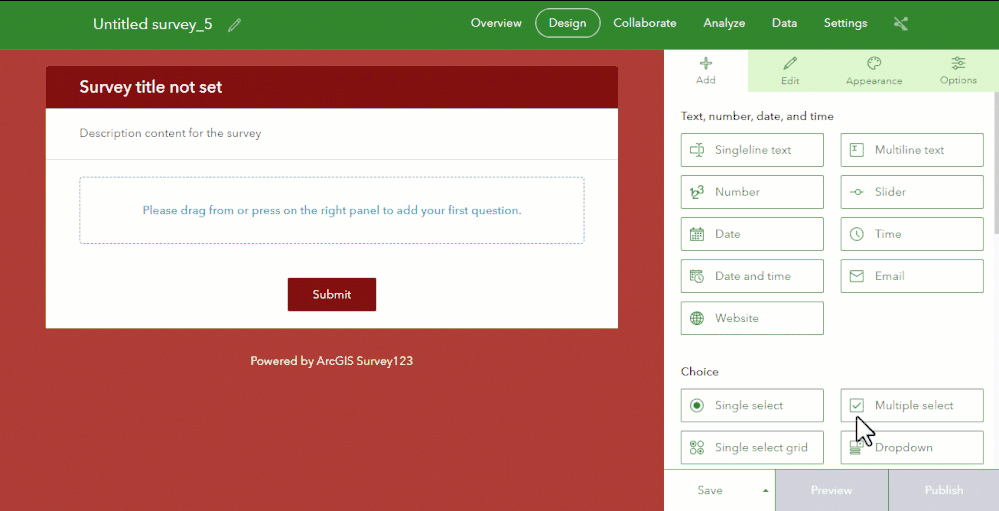

The animation below shows how to create a dynamic list in the web designer. In this particular case I am using the USA Current Wildfires layer, which shows active wildfires within the past 7 days in the United States from IRWIN and NIFC information.
