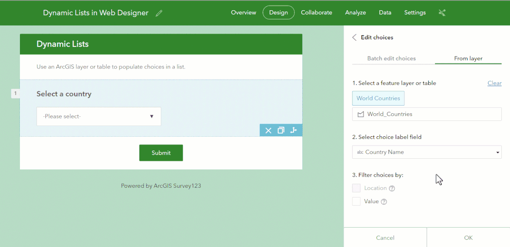

Let's build a dynamic list in the web designer: One that loads all records from an existing layer or table. I am going to use a World Countries layer from ArcGIS Online:
  • Login into the Survey123 Web designer and create a new survey
  • Add a Dropdown question into your survey and change the label to Select a country
  •  Go to the Choices section and click Edit. This will bring a panel where you can select your target layer
  • Click Add to select the layer. Change the target source to ArcGIS Online and type World Countries in the search box. Sort items by relevance to bring the Esri authoritative layers to the top. Select the World Countries layer and click OK to confirm.
  • Select Country Name as the choice label field. Click OK at the bottom to confirm and Preview your form. The list will populate automatically with all countries found in the layer.
