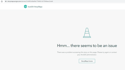

I tried again copying using your item ID and it went fine however after then I tried to edit/configure on the AGOL item page and it gives the below error. Do you see this error too on your copied version?

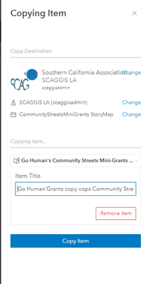

below is the screenshot for the workflow I followed for copying.
OwenGeo
Esri Notable Contributor
@SCAGGISLA -- When using ArcGIS Assistant, you need to make sure that the account that you're using to initiate the copy owns the story being copied. If not, the duplicate story won't be editable.

SCAGGISLA
Hi @OwenGeo  apologies for the little late response. I believe that's what I am doing. Please see the steps I am following. I feel it's a bug but requires your team's attention.
Step 1-
login to AGOL Assitant (sign in with ArcGIS Online) using the admin user
Step 2- on the top menu selected ArcGIS Online and then search the item (story map) which need to copy (id is 77097c02cb034a46a3a911ae7221e84b) the owner for this item is another user from a different organization.
Step 3- Select item and click on copy item option
Step 4- Copying item option displayed- choose an account to copy to. The primary AGOL account chosen which I used earlier to login to the assistant at step1
Step 4.1- option popups- this is an admin account. Choose a user within this organization to copy to..- a user was selected (same AGOL user with admin access which was used to login at step1)
Step 4.2- option popups- Choose a folder to copy to...(an existing folder was selected)
Step 4.3- click on the copy item button.
Step 4.3- button popped up  with the confirmation that copied 1 item (open in ArcGIS Online)
Step 5- the new item opened on the AGOL item page> click on configure> shows an error - Hmm... there seems to be an issue. The story builder can’t be loaded.
Also, this new item carried a new id on the item page but if check on the item setting page or in the assistant JSON editor then shows the original item id which was used to create the new one.
