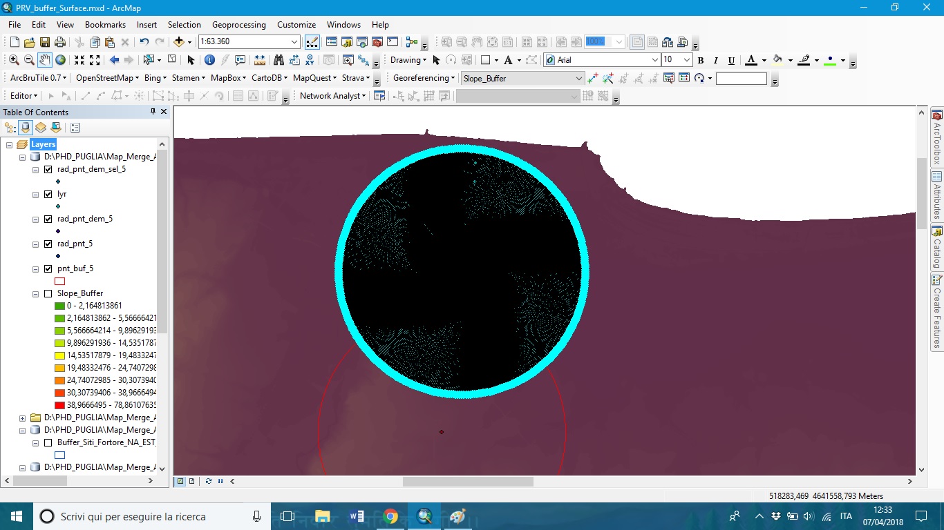

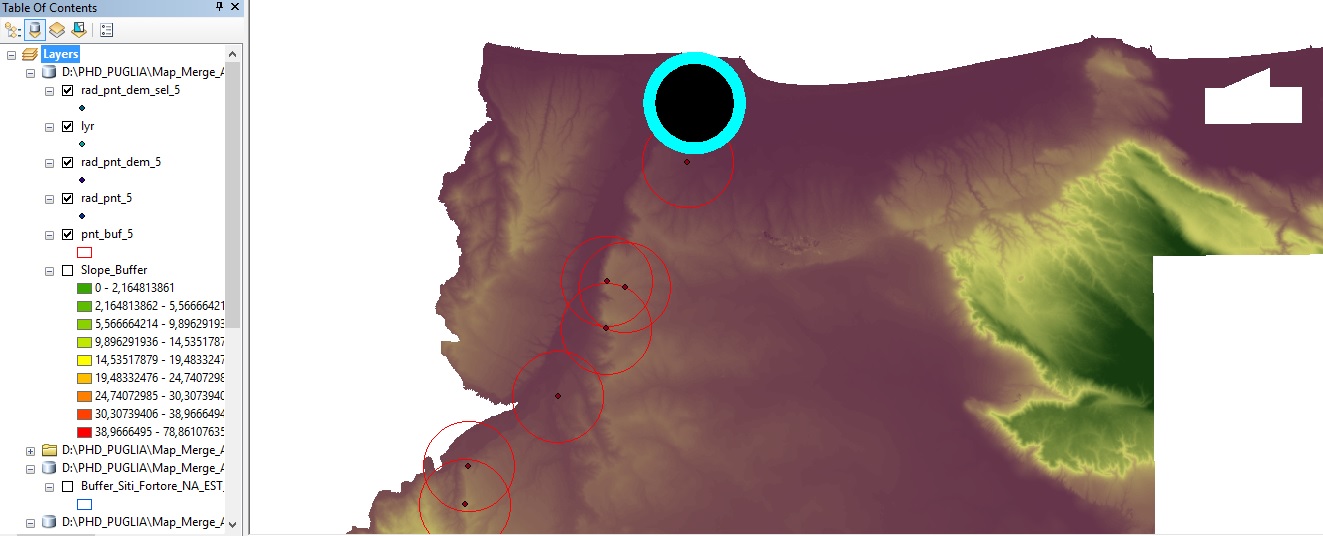

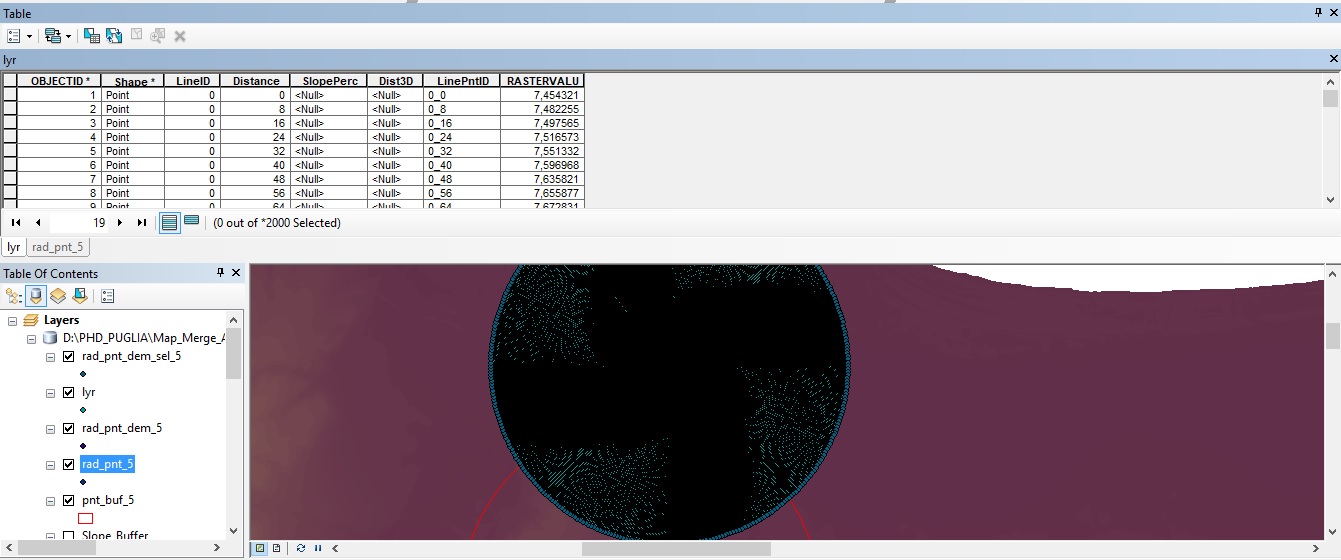

Well, I checked and I have not a buf_3D, so I guess I will have to try again the code; moreover, if I switch one all the layers created by the code I obtain that just only a buffer has specific info in its attribute table (as you can see in the pics; 1-general, 2-detail, 3-detail with attribute table). Therefore, I could consider it a mistake too.

I think at this point it would be best to run the code on the sample you provided me and see if you get the same results. If there is no result, it is not a matter of interpreting the result, but something is going wrong in the process. Als please attach the code that you are using so I can compare it with mine and see is there is something wrong with the code. Perhaps we should include some messaging in the code too to see what is going on.
