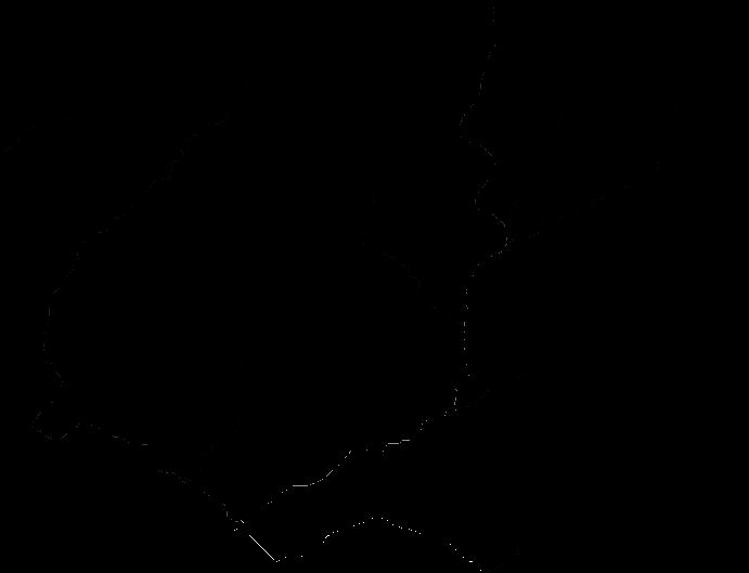

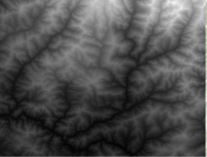

While using the watershed tool i am getting unnaturally huge catchment area. can it be a fault of the DEM i am using ( got from USGS-earth data website). Any suggestions please?

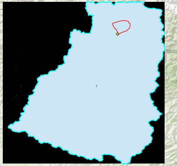

Thanks Dan for your response. I followed the following steps: Fill-Flow Dir-Flow Acc-Con( Value>500) - Stream Order-Stream to feature-Snap Pour Point( the distance didnt mattter if i used 5 or 500), Watershed( used processing extent as that of my DEM). I used wgs1984 projection throughout. i have added some pictures to clarify my
problem. the actual watershed as obtained from a paper toposheet is very small as compared to what was obtained from the watershed tool in arcmap.
flow accDEM

Note, I'm pretty sure I know what happened. Your SnapPour gave a tolerance to snap your pour point to the largest value with 5 <units>. Those units were 5 degrees, which is 300 nautical miles, so your point snapped to the highest flow accumulation cell in the raster.
