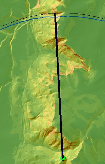

If I select a single line that passes through some relatively steep slopes (line Line_D 357):

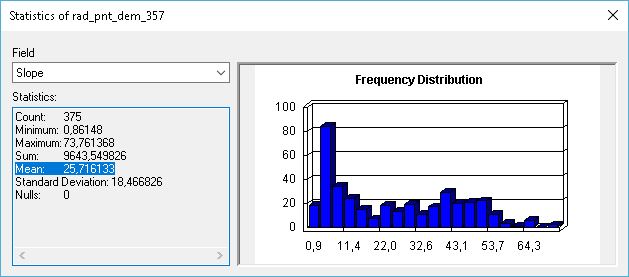

... and I extract the slope values, the mean slope is 25.7%:
This would mean that the buffer should pass at 2905 meters from the center point. It passes at 2920. The reason for this difference is that the slope direction is taken into account. If you traverse a steep slope maintaining the same altitude, you will traverse at a slope of 0%. A slope map returns the maximum slope in any direction..

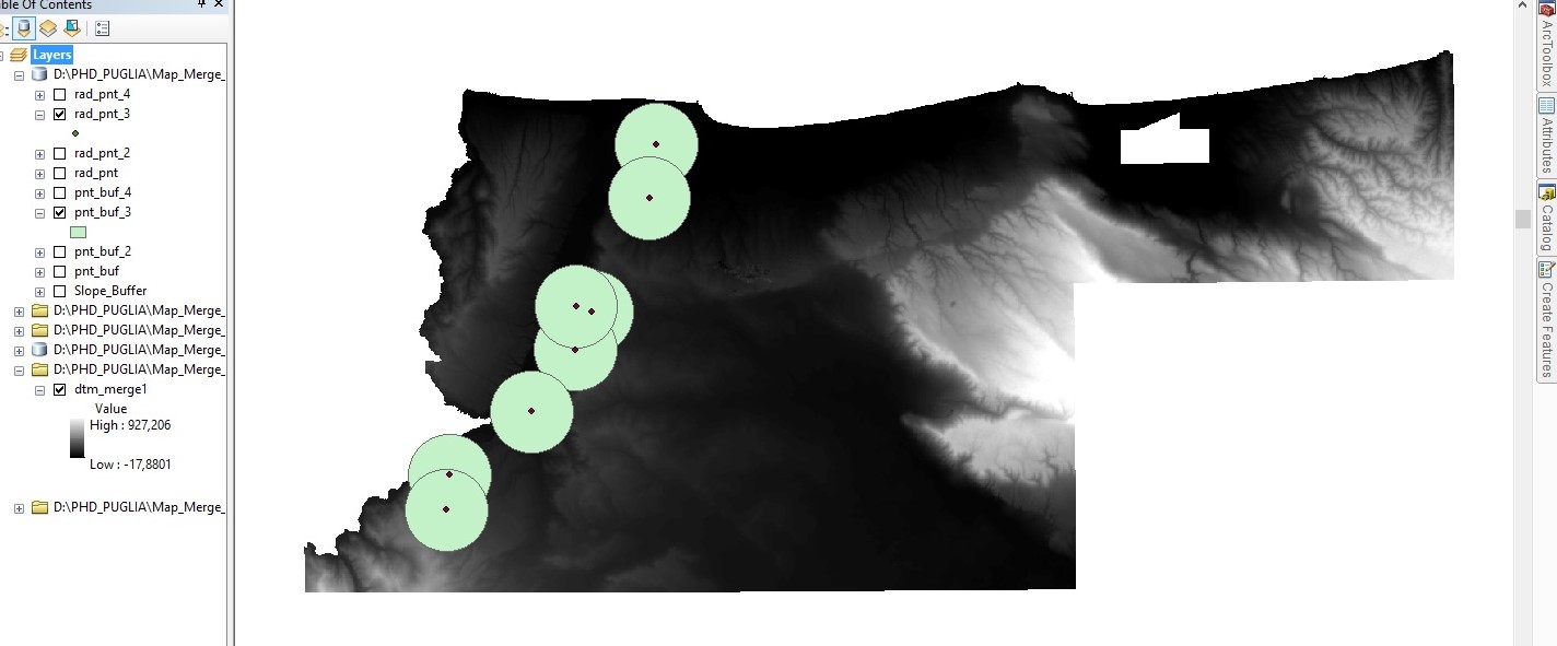

Ok, I will try to save and reboot the program. Anyway, the obtained raster is not like in the Xander's picture, it is "flat" as I had done it with the buffer wizard

well, my dtm values are High : 927,206, Low : -17,8801. I assume that with these values it should appear different (which means like Xander's pic). I tried another time using some points placed in a more hilly area, yet the circle buffer zones are stil "flat" without any surface adapting.

I attached some screenshots: DTM, points, slope, resulting bufferpointssloperesulting buffers
