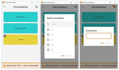

Hi Jesse, here are some ideas:
  • The Known species button. Create a data field with coded value domain (a list of valid species) and configure a button user input on this field for the button. You may want to create several of these buttons for known species, and group or categorize them by their family.
  • You'll also need a Other species button for the tree species that are unknown, and also set it with a button user input to take notes.

Hi Jesse, the example above is just an illustration of the concept, the key here is simply to apply the button user input to a data field that has coded value domain defined. We have a similar template called Marine Debris Sampling. You can try it directly in the QuickCapture mobile app (Continue without signing in), and if interested, deploy it to your account in QuickCapture designer and customize your project based on it. You can also send us your feedback at [email protected] or if you have any issues setting up your project.
