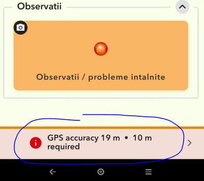

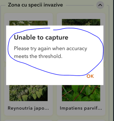

It is possible to change warnings messages language or edit the messages in quickcapture?
I have looking in Json but I didn't found the messages.
Thank you.
Best regards
Adrian
AdrianPatrulescu_0-1643890546416.pngAdrianPatrulescu_0-1643890546416.pngAdrianPatrulescu_1-1643890625400.pngAdrianPatrulescu_1-1643890625400.png
Mandy_Li

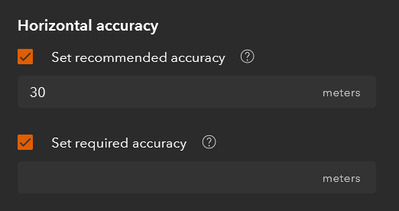

Hi, the language used is determined by your device's language setting. The message shows the current location accuracy on your device as well as the horizontal accuracy set for this QuickCapture project.  You can update the recommended and required horizontal accuracy from the Web designer > Project general settings > Horizontal accuracy. Note you cannot capture a record until the required accuracy threshold has been met, so you may want to increase this value for your project in order to capture a record.

AdrianPatrulescu
Thank you
I was change the device languages and the the warning messages was changing according to the languages
I don't need to change the required accuracy I only need the user yo understand why is unable to start the record
