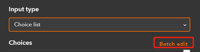

Is there a way to upload a list from a word doc or spreadsheet?
It doesn't have the Import from file function, but you can try Batch edit which you can copy and paste your list from a word document to the text editor. This will save you time if you have a long list to enter.
