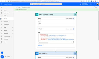

StefanUseldinger
Thanks for Your screenshot. Can You please share the Microsoft Flow template for all QuickCapture events (project details, server response, submitted record, user information, portal information)?
From Your screenshot, i can just guess the template for the event "project details":

TylerSelby
New to the thread here, I was able to get this to work with Power Automate to send the email after HTTP request, however I can only get it to show the "body" in the email, even if I use the json parser tool in automate, it does find the variables  after parsing but wont display them in email. just the raw payload form quick capture in body. Was anyone able to to parse this?
