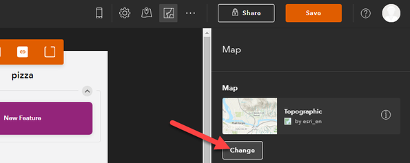

Is there anyway for the mobile user to view points already collected in the app? I have a feature layer with some points already collected and would like to avoid duplicates.
JohnathanHasthorpe
Hi - Yes, you need to create a web map in the ArcGIS Online map viewer and add your project layers to it. Save the map, and the QuickCapture Web Designer, set the created web map as the project map.
Once the QuickCapture mobile users download the project update, they will be able to see submitted features in the map.
