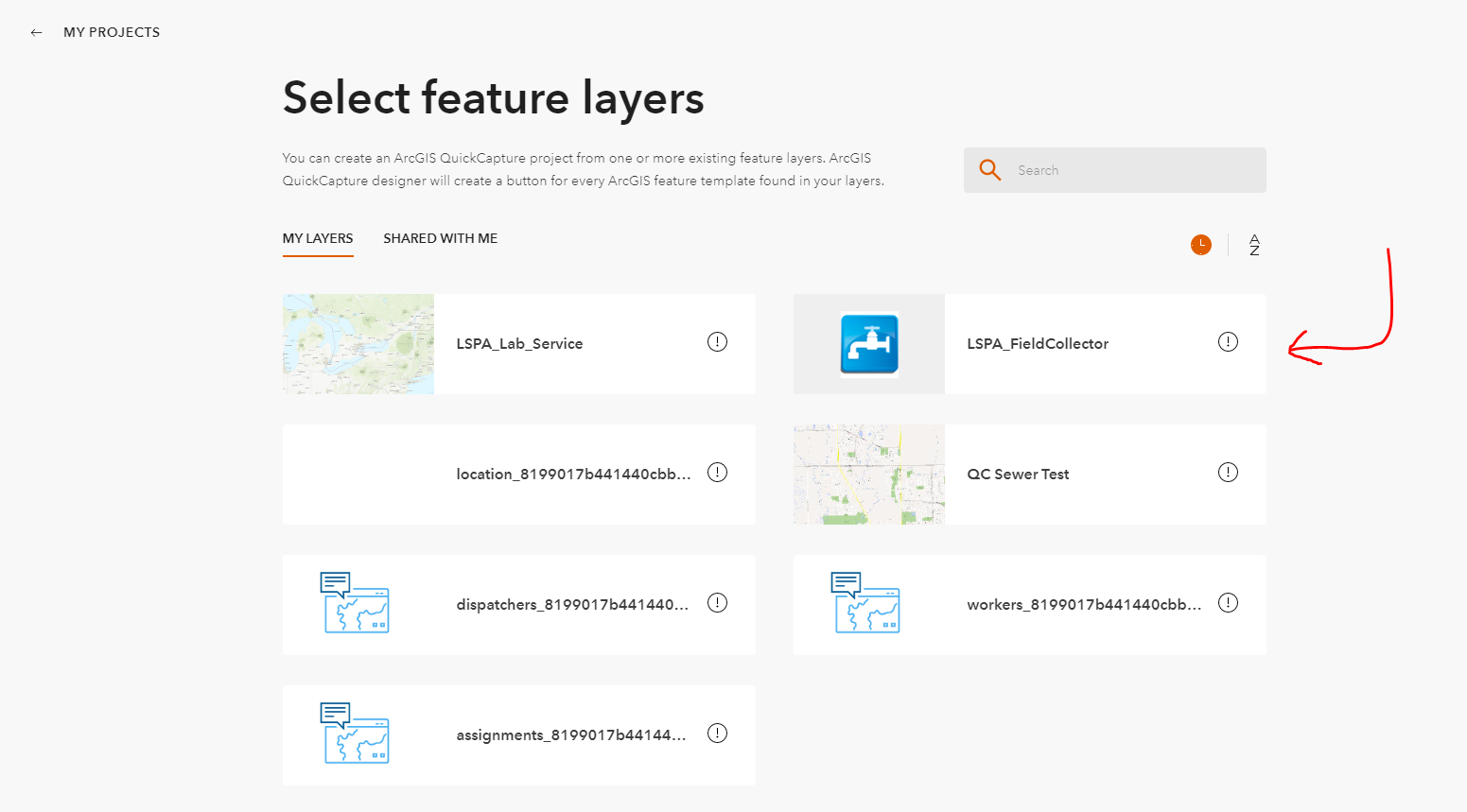

Hi,
I'm trying to add a Feature Service URL to my ArcGIS Online account so I can then add it to a QuickCapture project.  When I add it to ArcGIS Online it shows up as a "Feature Layer", but whenever I click on it in the QuickCapture Designer the interface asks me to Login to QuickCapture again, and then brings me back to the start of the process.
Here are some images to help explain:
1.  This shows all my available services.  I want to use the one with the red arrow.

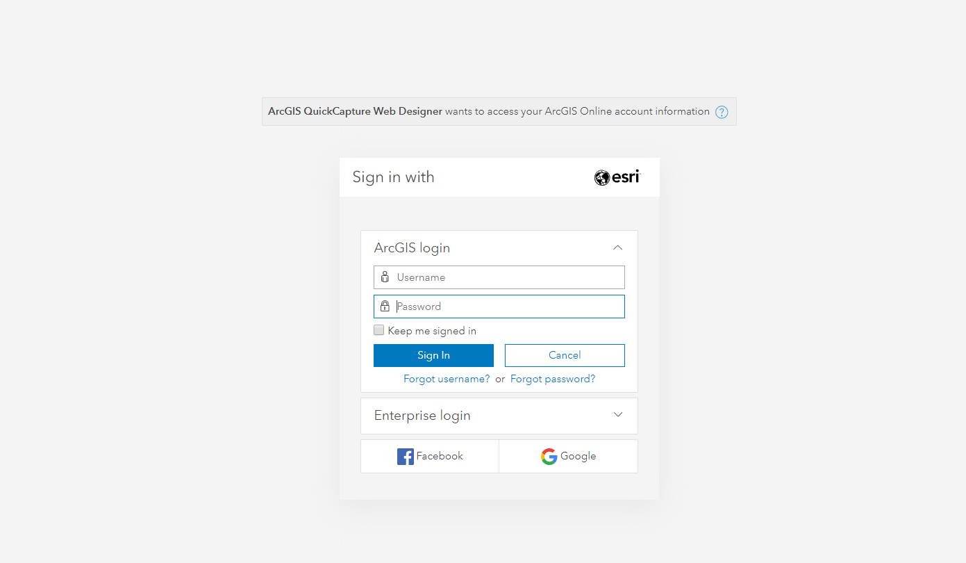

2.  Once I click on the desired service it brings me back to a login screen (even though I am already logged in):

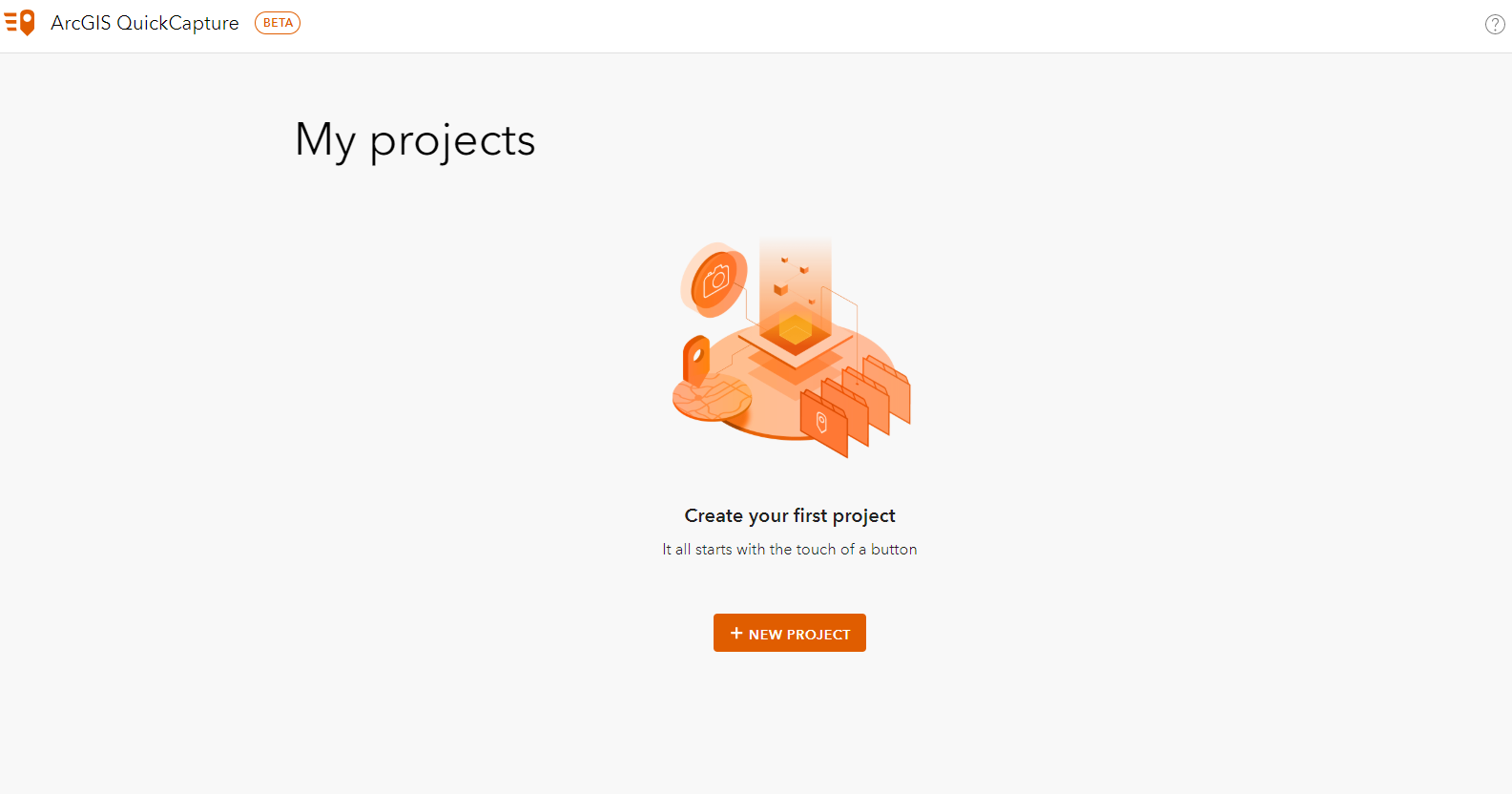

3.  It then brings me back to the start:

Hi Brian
As the server service is unsecured, when the designer tries to access it using the same token used to access the online item, it will fail. Essentially, ArcGIS server does not like getting a token when it does not need one.
The workaround is to secure the service using token-based security and then add it to an online item, making sure that the credentials for the service are saved into the item. This means that the item will act as a proxy and allow the online token to provide access to the server service. If you don’t want to secure the original public service, you can always create a new service that points to the same data and secure this one.
