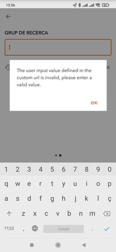

Problem 2: User input in url is invalid
As I said our project has 2 inputs, none of them are mandatory. Using the provided URL with only one of the userInputs, always says that the second input has an invalid value.
 user input invaliduser input invalid
We also tried different configurations, or even reordered the input ids (001,002,...) without success. The requirement is to have 2 inputs, but only pass at the URL one of them. Is this possible?
thanks in advance!

For problem 2 - Can you share the project and layers with the following user QCCreator. You will need to create a group and invite the user to the group (and share the project and layers with the same group). I'll test the project and confirm if this is a bug.
Thanks

Problem 2: Still present with 1.17.23. Cannot share it, as it's an enterprise portal, not AGOL.
I can provide you a recording (will expire in few days): https://drivebox.nexusgeografics.com/f/be326ac4248e4474b532/
and the json definition of the project (urls replaced), hope it helps:
