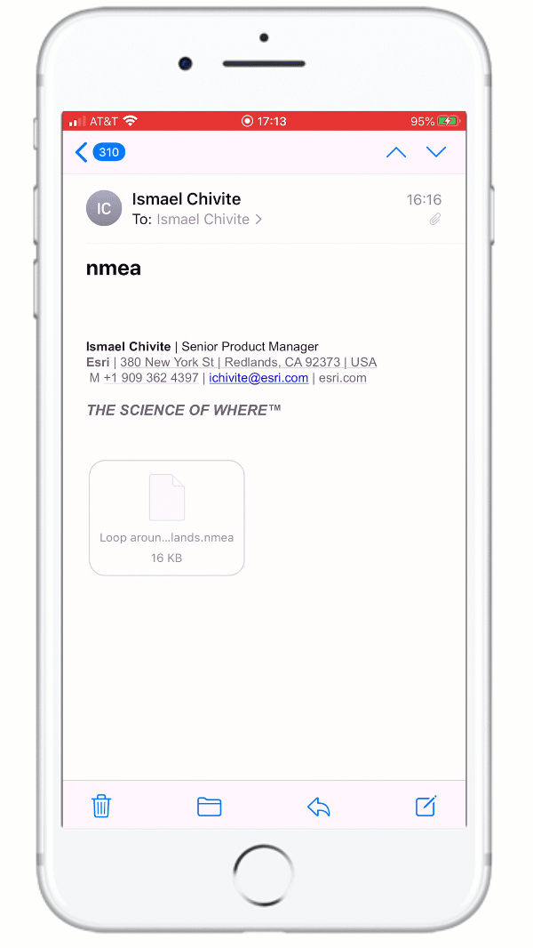

In iOS, the easiest way to transfer the NMEA file is via e-mail, as an attachment:
  1. Add your NMEA file to an email as an attachment and send it to yourself.
  2. In your email client, select the attachment file and swipe up
  3. Select Save to Files and move the file to the QuickCapture directory.
The animation on the right side shows the steps. You simply need to use the operating system 'Save to Files' option and select as the destination the QuickCapture folder in your device.

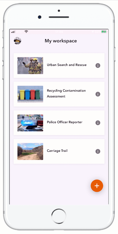

  1. While in the project gallery, tap on your profile icon.
  2. Go to Settings
  3. Open the Location Provider section
  4. Tap on Via File
  5. Browse for your NMEA log file
  6. Tap on Add (IMPORTANT!)
  7. Return to the project gallery and open your project
Once the file location provider has been set, your location will loop through the coordinates in your NMEA file. Speed, direction of travel, fix time and other properties will be honored.
