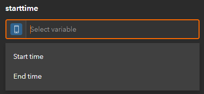

HuongTran1
Johnathan Hasthorpe‌ the application capture created_date by default is it possible when creating a line feature to capture start and end time?
Thanks
Huong
JohnathanHasthorpe
Yes, but only for buttons pointing to line or polygon layers.
In the designer, if you create a button that points to a polyline layer that has 2 dateTime fields (one for the start time and one for the end time), you will be able to apply the startTime and EndTime variables to them in the data tab.
HuongTran1
Thanks Johnathan Hasthorpe‌ it worked perfectly.
