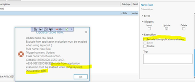

Our team is trying to use Arcade to do some data updates without success and I have reduced the update to be the simplest possible. Basically, this is to copy the data to 'notes' when this field changed. I am on pro 2.7 and I am using file geodatabase. Could anyone see what is wrong with this arcade expression or do I need to configure something for update via arcade? Thanks in advance for any helps! Following are the screenshots of the error we received and the arcade expression.

I accepted one of the above comments from @SarahHartholt as a solution since her approach should be the right way to go to update a different field in the same feature. To update a field in a different feature using the "Edit" in the payload, the trick here is to edit on the "Attribute Rule" to trigger the rule, which will display a very nice message to tell us exactly what to do: there is a checkbox need to be enabled.
