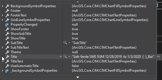

I am having heartburn getting Chart Titles to properly update for Calendar Heat Charts and Clock Charts.
The application (Pro 2.7) iterates through all of the charts of a feature class.  I have tracked the values through debugging and can see the title property is correctly defined.  However, any Calendar Chart or Clock Chart do not honor the new title.  Line Charts and Bar Charts work with no grief.
If I close the Calendar or Clock Chart pane and reopen it, it does then carry the correct title.

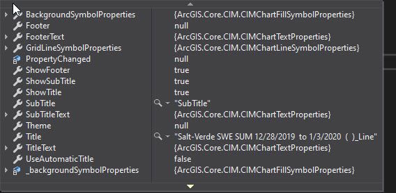

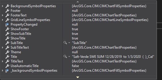

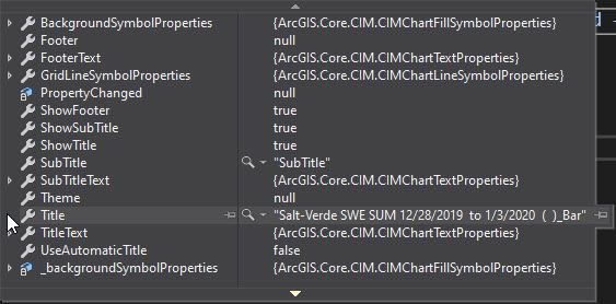

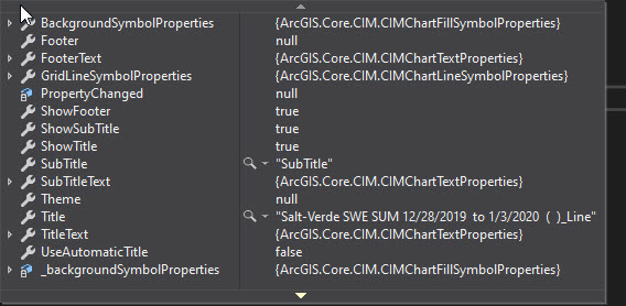

I have included some screen shots from Visual Studio that shows the values correctly populated for each chart  Note the Title property value references the same dates ( 12-28-2019 to 1/3/2020 )
chart type. VisualStudioLineBarVals.jpgVisualStudioLineChartVals.jpgVisualStudioCalChartVals.jpg

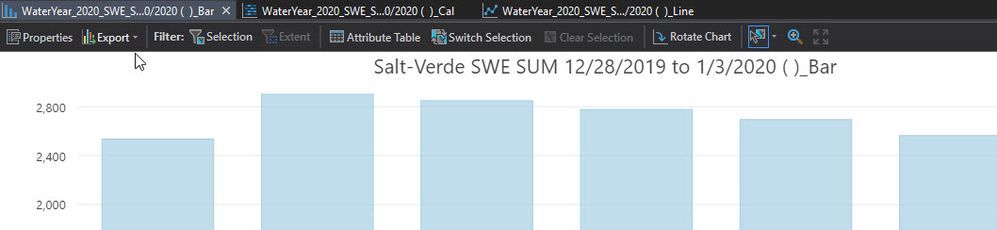

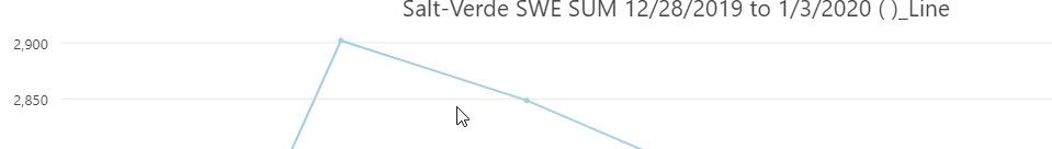

The following screen shots show the results from Pro of the Charts.  The Bar Chart and the Line chart title contains the correct dates.  The Calendar chart  does not show the correct dates.
Bar Chart ResultBar Chart ResultLine Chart ResultLine Chart ResultCalendar Chart ResultCalendar Chart Result
