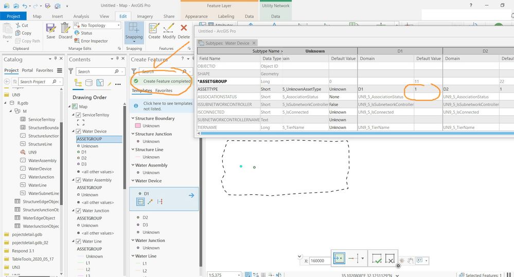

Right. I got the same error (Failed to create new feature: Value doesn’t fall within the domain: D1) and resolved as a default value for the subtype is added
