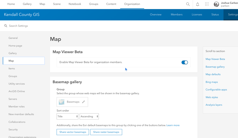

Part of the trouble with a problem like this is that what you see when you click "Imagery" on the basemap switcher may be totally specific to your organization. The contents of the Basemap Gallery in Pro, just like the web maps and apps, is populated based on a group in the Active Portal you're signed into, whether that's AGOL or an Enterprise Portal.
Those basemaps are really just Web Map items in AGOL / Portal. In order to diagnose / fix the issue, you'd have to go to the web map and check its settings, layers, etc.
If you're an admin-level user for your active portal, go to Organization > Settings > Map > Basemap Gallery. There you can see what group's contents populates the basemap gallery, as well as whether Esri's own basemaps are currently shared with that group.
You can then browse to that specific group's content to make changes to the map as needed, or even remove / replace items entirely.
