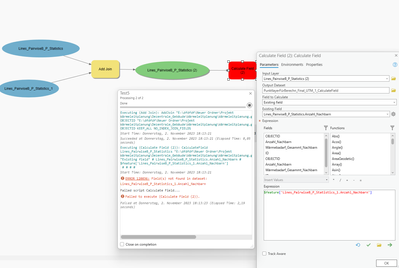

I tried that allready. Check out the picture. Maybe I did something wrong?
SebastianEnnenga
That is the error I receive.
Robert_LeClair
Esri Esteemed Contributor
Right.  So two things I see is the GP tool says you have pending edits.  You'll have to save or discard edits first as this is a schema lock on tables.  Second, your Expression is incorrect.  You do not need to have an equal sign on the leading part of the expression.  Clear this whole line and double click on the Anzahl_Nachbarn field.  This will populate the expression for you with the correct syntax.

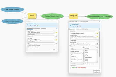

SebastianEnnenga

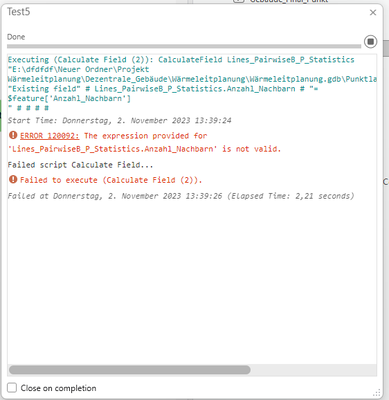

Ok, I saved everything ,delete the eqal sign and just doubleklick on "Anzahl_Nachbarn". Now I got this error:
Robert_LeClair
Hmmm...so this error means the field to be calculated does not exist.  Is this field in the spatial table or the non-spatial table via the Add Join?

I dont know if understand your question. Lines_PairwiseB_P_Statistics & Lines_PairwiseB_P_Statistics_1 are exact the same tables with same attributes. Only the values are different.
