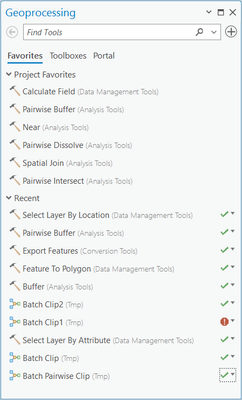

See screenshot below.
How can I clear (remove) the Project Favorites tools list or the Recent tools list?

I figured out I could Remove the Favorites tools by right-clicking the tool in that pane.
However, that option is not available for the Recent tools list, so thanks for pointing out that it's essentially one in the same as the History list, and can be removed from there.
