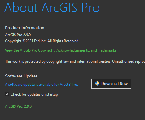

updated to ArcGIS Pro ver 2.9.0; still being prompted to update when I open Pro
5742
6
11-18-2021 09:59 AM
wilcow
I noticed the update alert and Downloaded the install, but when the install completes and I reopen Pro, it still prompts me to download the same update
Anyone else seeing this? is there a workaround or fix? I've seen another issue with 2.9.0 that I'll describe in a different post
wilcow
clean install (seems to have) fixed this issue

Based on your other post, I suspect that you have an install issue, so you can try
Windows, Add/Remove Programs, select Remove, then Repair.
If that doesn't work, you should download the installable *.exe for 2.9 to your local machine from My Esri
Completely uninstall 2.9, then reinstall from the *.exe.
If you already downloaded the *.exe, you can use the *.msi to reinstall Pro.

I was unable to uninstall completely - keep getting "Error 1714: The older version of ArcGIS Pro cannot be removed".
I found some steps from EsriBeLux on doing a clean uninstall, but still the error persists.
I opened a support ticket to sort it out
