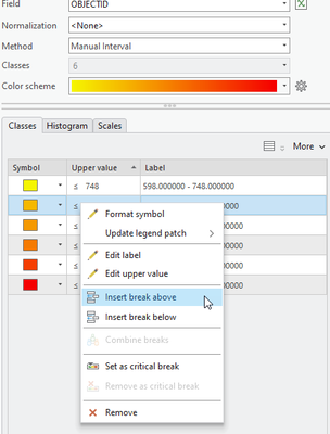

I see this topic has been linked in another similar topic, so post my same answer here, hope it will help. And please share more info if your case needs other solution, thanks!
This is by design. Because with customized classes, it will be hard for us to decide where to add a new one or to remove which class. Any action might ruin existing manual classifications, so we grey out the classes control.
W have this more flexible function to update classes: if you right click on a row, you can choose to add a break above or below, this will update the number of classes and don't need to switch to another method.
