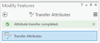

Transfer Attribute Tool is now available but it seems not working or I maybe missing something.
It seems pretty straightforward but it simply not transferring although message "Attribute transfer completed"
I have tried Saving Edits ( included when u save d project ), re-open the Table, re-open the project but nothing happens.
