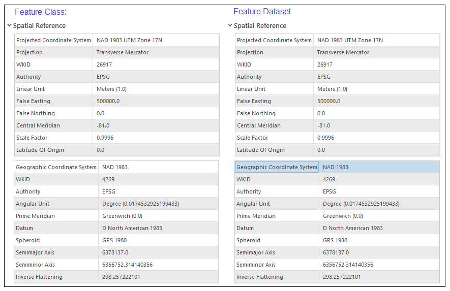

I took a look at the properties of the FC and the FD. The spatial references appear to be identical:
Does anyone know why I might be getting that error if the spatial references are the same?

the constraints go beyond the spatial reference class/name to include
This includes the coordinate system, either geographic or a specific projection, as well as coordinate units and tolerances for x-, y-, z-, and m-values. All feature classes in a feature dataset must share a common coordinate system, and the x,y coordinates of their features should fall within a common spatial extent.
Are there differences in any of those?

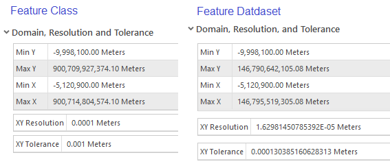

It looks like the FD's XY Resolution and XY Tolerance are wrong. I don't think those values should be so small...I'm guessing they should be set to what the FC has (0.0001 and 0.001) which are likely the defaults.
I'll look into fixing the FD. I don't imagine it'll be easy.

I can't say for sure, since I haven't been involved with this data until recently. But it could have been this:
People other than me undertook an initiative a couple of years ago where they cleaned up and merged some FCs in the FD. That wouldn't have been easy to do while the data was in SDE, due to locks, testing, etc. So I think they probably put a copy into a FGDB or a PGDB (ArcMap), did some "novice things" with GP tools, Python scripts, etc.. Then they would have deleted the original from SDE and copy/pasted the modified version back in. The tolerances could have gone awry as part of that process.
