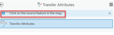

Once you have applied your Field Mapping Settings from the Editor Settings burger button, follow the informational notifications on the tool to select the source and target features on the map - https://pro.arcgis.com/en/pro-app/latest/help/editing/transfer-attributes-between-features.htm

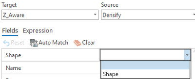

Please note that to transfer geometry, you need to match the Shape fields of the source and target layers in Field Mapping - https://community.esri.com/t5/arcgis-pro-questions/geometry-transfer-in-arcgis-pro/m-p/1016232#M3593...
In ArcMap, this was implemented by checking the 'Transfer Geometry' box.

Having this same problem- and in Arcmap (if it was points overlapping) it respected the order of target and source. I got my stuff to work by turning off my target> clicking the transfer tool and the source point> turning my target point back on and clicking. It doesn't look like the tool recognizes the order if the features are overlapping. Maybe this is isolated to points- but I wonder why this is happening and what I can do about it?

I tried if it worked changing the layer order. It didn't but it has effect. When getting source features the source has to be on top or the target should be switched off if it is on top.

I can't get this tool to work at all using any of these methods. I'm trying to transfer geometry (I selected Shape in the attribute mapper) from one polygon dataset to another and it's just not happening.
