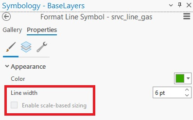

the issue is the "Enable scale-based sizing" is greyed out in some occasions, when using "unique values" method
in this case, the line symbology I use could not be applied
