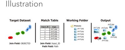

The illustration above shows linking (1) Path Field to (1) Input_ID.
Again, I am trying to link multiple Path Fields to (1) Input_ID.
Also, my workflow is slightly different. Specifically, my [Input_ID] matches my [Path Field] name identically (only difference is [Path] has .jpg at the end).
