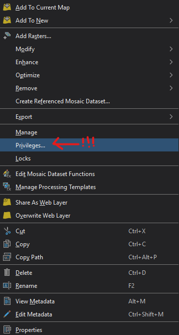

@RogerDiercks1 Greetings!
This may be a bit delayed, but I remember looking at this thread a while back when I couldn't find this button that was in ArcMap for mosaic datasets. It's been added and is very useful for managing mosaic datasets in an enterprise database!
Jon
RogerDiercks1
Thanks for reviving this topic! I'm running Pro 3.3.2 now and had completely forgotten to check to see if it was ever added. It's definitely there! While my very simple Notebook in my project for managing imagery has served me well to set privileges, I'm glad this has finally made its way into Pro.
