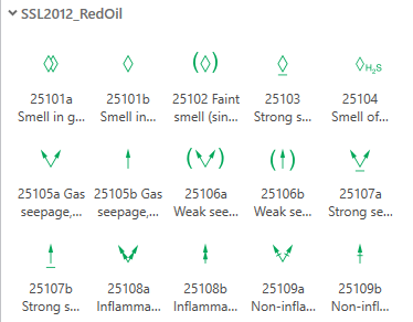

In ArcMap, there were preinstalled petroleum symbols for wells, etc.  In ArcGIS Pro, one needs to download a .stylx file.  I downloaded the Shell Standard from ESRI here:
https://esri-styles.maps.arcgis.com/home/item.html?id=8a89e7ffe4154efa94c65090c4dab485
The symbols just show up as Capital letters and not the well or other standard petroleum symbols that are described in Shell's data.  I've attached a picture.  Anyone know how I can fix this?
BarryNorthey
When you add the style to the Project you might get prompted to upgrade it. If so, do so.
Be sure to Install all the fonts that are in the Shell Fonts folder in the zip file. To do so, open the Shell Fonts folder -> highlight all the Fonts -> right click -> Install.
You might have to restart Pro for this to take effect.

ScottSeay
Thank you for your help!
