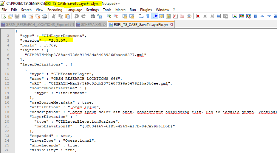

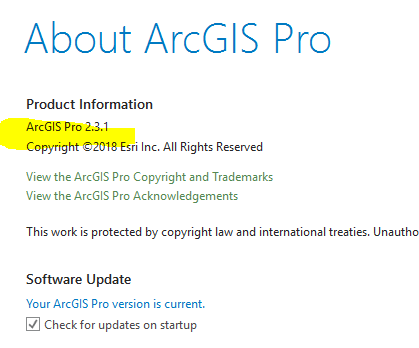

Scott HarrisKory Kramer this may be totally irrelevant but....in trying to repro (chasing down the layer file cause), I notice that in Pro 2.3.1, when I create a layer file, the xml header is showing version 2.3.0....
