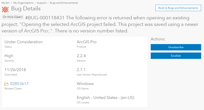

This is happening to me in 2.9 with multiple projects.   Unfortunately, none of the workarounds are working and the bug # mentioned above is no longer in their system...
GeneOlig
Bug has been escalated with ESRI.
JenniferOtter
That's weird.  Searching for that bug# gets me nothing.  Thanks!
