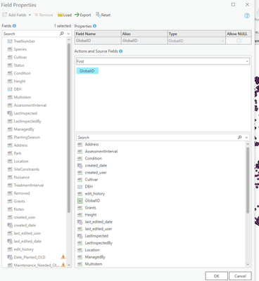

LMedeirosUI
@ZachBodenner  I saw the pictures, but I was hoping for a screenshot of what you did in the field mapping dialog box (see attached screenshot) to "set" GlobalID of B to be equal to the GlobalID of A. By default, that's what mine is set to but I wanted to see if I was missing something.

Ah I see what you're saying, no it looks like you have it set up correctly. Here's mine:
I've done mine in local FGDBs and also our primary Enterprise Geodatabase. Nothing online. When you say you're doing it in a related table, are you trying to migrate an entire parent AND child dataset (ie. feature class and related table)? Whether it's a table or a feature class shouldn't make a difference.
