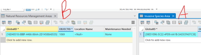

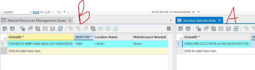

I've been having some trouble using the updated append tool since upgrading to ArcPro 3.2. So I have  a feature class (A) that I am migrating to a new feature class (B).  A has global IDs enabled, which are required for photo attachments and a related table, and so B feature class must have them enabled as well. I set up Feature Class B and enabled Global IDs.
Okay, so now when I go to append features from A and use the field mapper, GlobalID is one of the mappable field. If I run the append by filling out the GlobalID field, the correct Global ID does not get written in to dataset B - it's just a new GlobalID

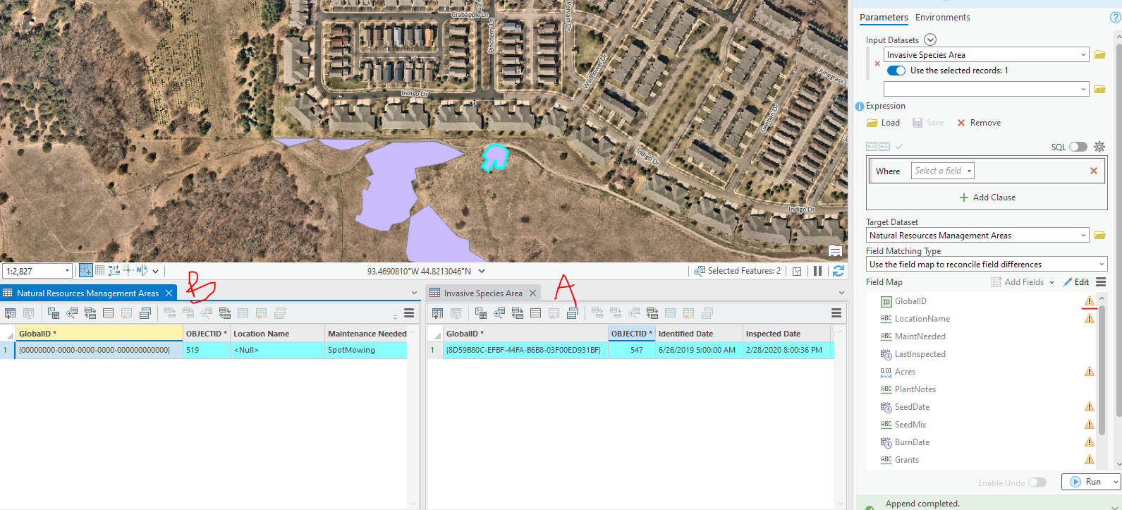

I discovered this after my initial workflow failed: I went into the environment settings and selected Preserve GlobalIDs and then left the field map option blank. But that results in the Global ID of feature class B being written as 000-...
Which, if I'm appending more than one feature, will fail on the second feature because it's trying to write the same value to all the records.

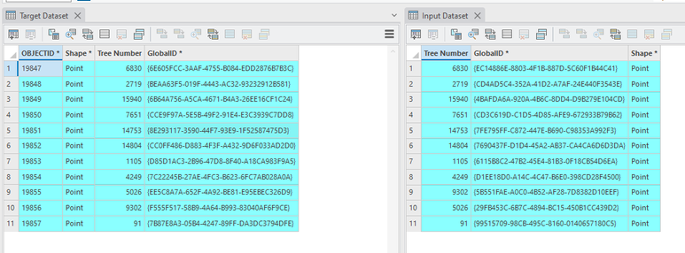

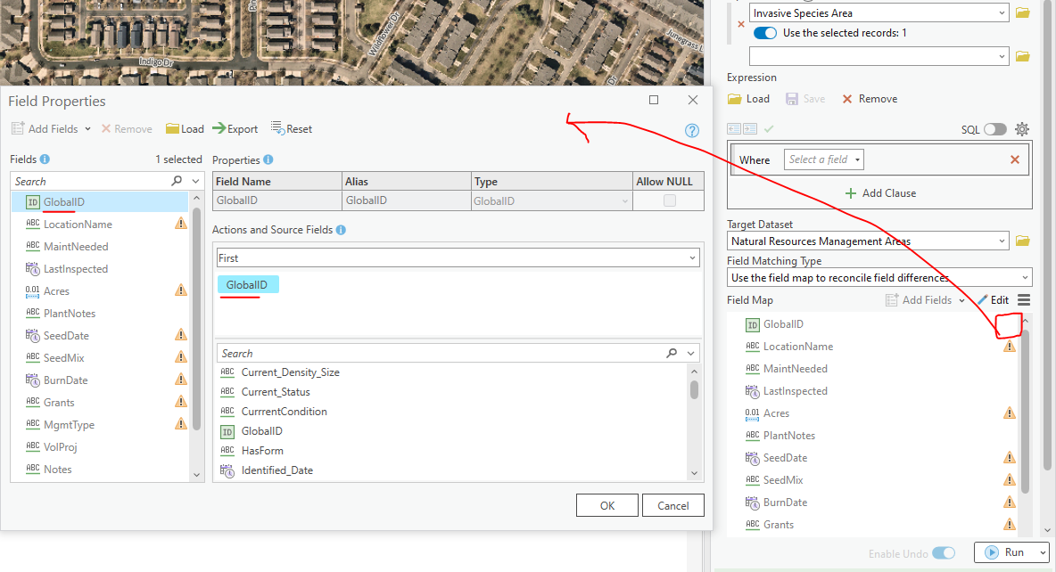

Absolutely! I will illustrate with pictures:
Attempt 1: I use the field mapper to make sure that the GlobalID from my input dataset is being written into the GlobalID of my Target Dataset. I leave the environment setting "Preserve Global IDs" unchecked:
 When I do that, you can see that the GlobalID is not actually written in correctly:

Yes it definitely should, though as I mentioned in the original post, when I had the field map Global-to-Global not set, but the tool environment Preserve Global IDs toggled on, I was getting a tool failure.
