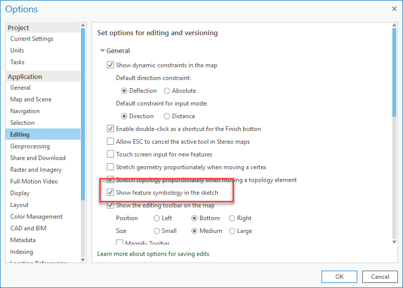

Try toggling this option to see if that makes a difference:
Thanks,
Scott
JustinJohnston
Hi Scott,
This did not make a difference. Any other ideas?

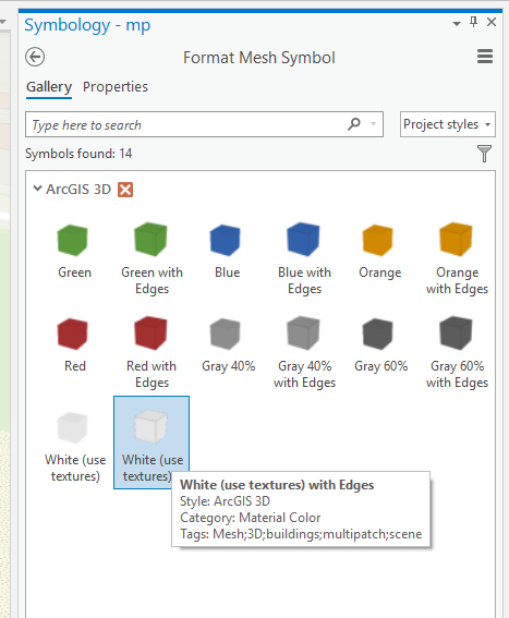

My current hunch is that the problem is related to the symbology, have you tried to set the multipatches to a filled symbology (try the one below) instead of the "wireframe" looking symbology you are currently using?
Thanks,
Scott
JustinJohnston
Hi Scott,
I have tried different symbologies. I thought the same thing. It still disappears when trying to edit vertices. To test things, I did create a new multipatch feature class and manually drew buildings. That worked fine for editing. I also tried creating a different new multipatch feature class and retried copy/paste special the buildings made from polygons into that to see if it was a corrupted feature class I was working with causing the disappearance. The new feature class still disappears if I try to edit vertices. My sense is that there is a flaw in the copy/paste special functionality when copying from polygons to multipatch feature classes.

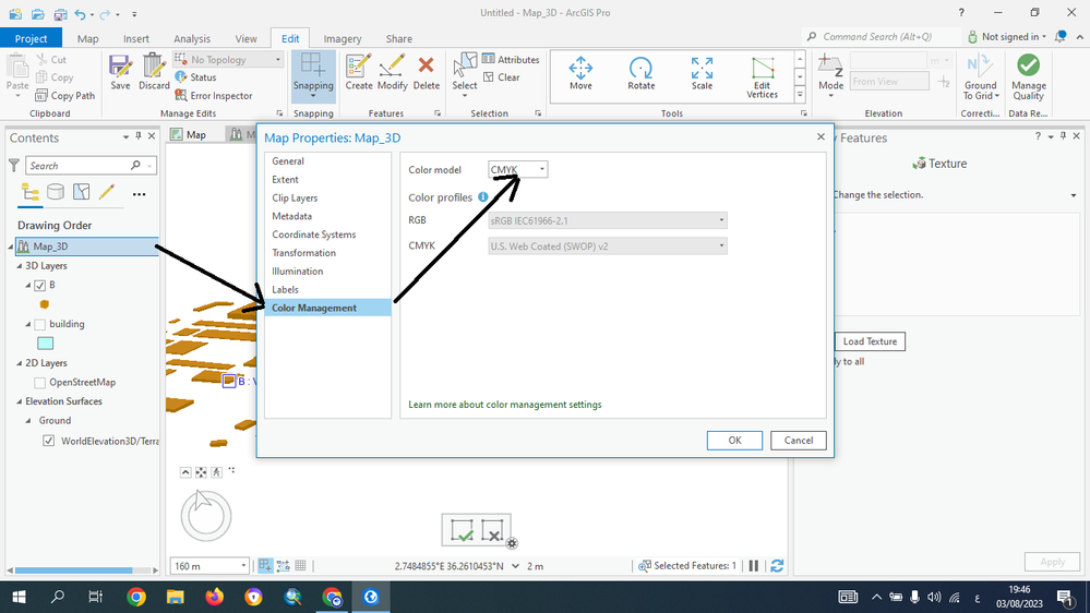

sadiqtahmi1
You can change the color mode from RGB to CMYK, I tried that and I think it is a suitable solution for this problem, see the attached image
