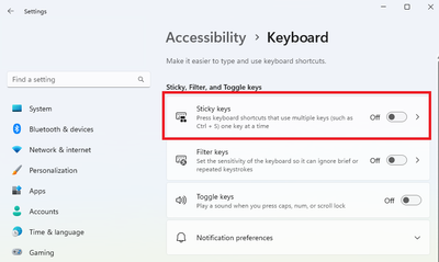

- Do you have Sticky Keys turned On ?
Windows Settings > Accessibility > Keyboard.
