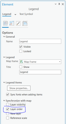

Why can't I drag a legend item to a new column in Arcgis Pro 3.0.3? I'm in "Manual columns" Fitting Strategy and set the number of columns to 2, but I can't drag an item from Column 1 to Column 2.
AubriOtis
Do you have layer order checked on in the legend properties? When that is checked the legend items fall in the same order as the layers and drag/drop doesn't work.
Cheers,
Aubri
ChrisLeach
Thanks Aubri. I figured it was something simple I wasn't doing. 🙂
