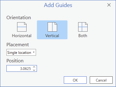

In the meantime can you not specify exactly where you want Guides to be placed without visually mousing using Add Guides?
For example, I want a vertical Guide placed at exactly 3 1/16 inches (3.0625 inches).

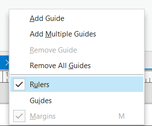

In 3.2.2 there is no "Add Guides" option. It's called "Add Multiple Guides" I think it's called "Add Guides" in 3.3?

You are correct. I posted a screen shot of what you see when Add Multiple Guides is clicked.

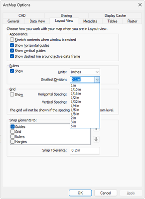

@TomBole& @KoryKramer Any news if the enhancement request ENH-000114737 has gone anywhere? Below I included a screenshot from ArcMap 10.8.2 showing exactly what I'm looking for, and I suspect what the OP is looking for too. I would add that an increment of 0.01" would be beneficial too. I'm looking to recreate a layout from an AutoCAD titleblock in an engineering style. See the second screenshot for the look and feel I'm going for. If it's not exact to 0.01", I'll use a different technique or different software.

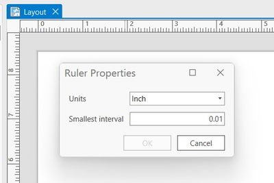

@DavidDurst - ENH-000114737 was addressed with version 3.3. The help topic Set up a layout has been updated to account for this change. Here is the relevant information.
To customize the ruler, complete the following steps:
Right-click a ruler and click Ruler Properties.
The Ruler Properties dialog box appears.
Select a unit from the Units drop-down list.
Use the Smallest interval box to set the smallest interval the ruler displays.
Setting the smallest interval doesn't mean that only that interval is shown on the ruler. As you zoom in and out, the ruler updates to reflect intervals appropriate to the zoom level. Adjusting the smallest interval means the ruler never shows a value smaller than what is set.
Here is a screenshot of the dialog.
