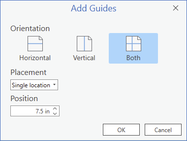

You can set Guides without using the Rulers using Add Guides (right click on any Ruler). Not sure what you are doing with the Legend but you can set the spacing of elements in the Legend element in the Legend pane under Legend Arrangement Options tab --> Spacing
