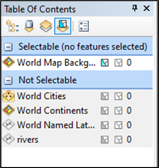

Hi There,
After you have used 'Make this the only selectable layer' is there a way to make all layers selectable again without having to go through and check each layer.
Thanks,
Phil
shan_sarkar
For ArcGIS Pro, perform the same steps and use the "Space Bar" to toggle on/off the layers from selection. I tested it and it is working.
~Shan
shan_sarkar

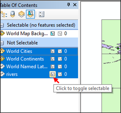

Hi Phil,
It seems once you specifically mark a layer for “Make this the only selectable layer”, you might end up having to manually toggle on selection for the rest of the layers. However, assuming you have quite a few layers in the TOC, you can simply switch over to the “List by Selection” tab and select the first layer that have selection toggled off and then scroll down to the last layer in the TOC and Press Shift and select the last layer in the TOC and it will toggle on selection.
This way you do not end up having to select each layer and can switch toggle on/off on layers. In case you want to toggle on/off selection on specific layers you can replace the Shift key with Control key and follow the rest of the process.
~Shan
